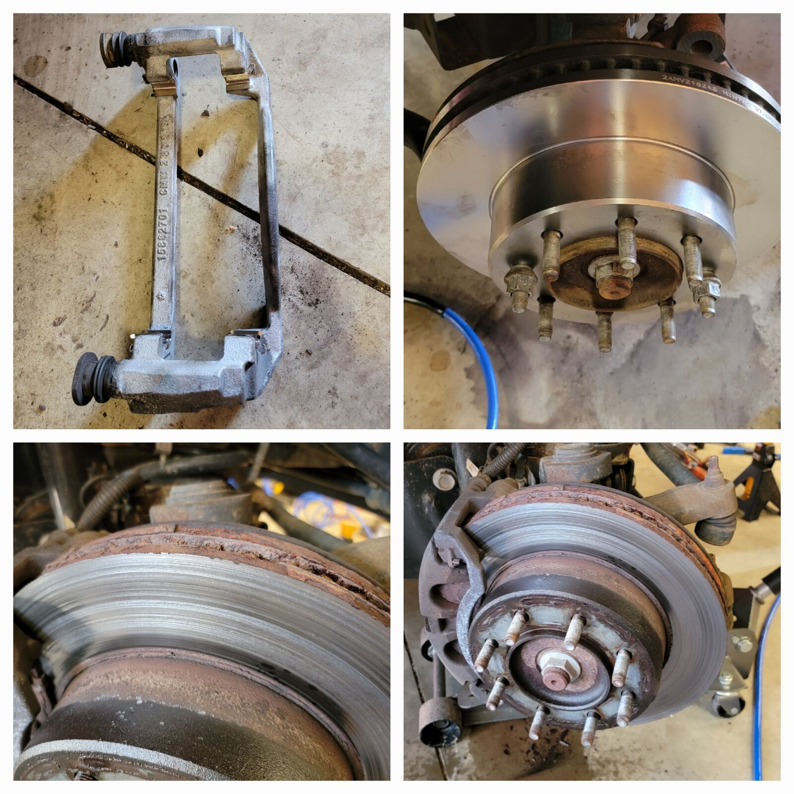

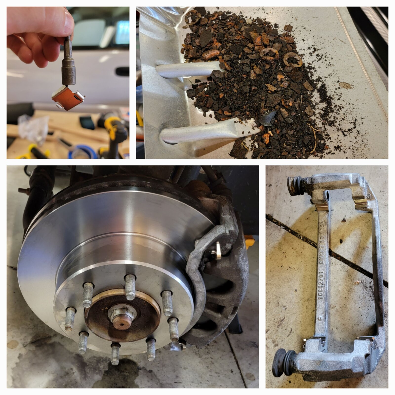

it was not that the rotors were that bad, but my pad sliders the little stainless deals were all messed up and the pads were mushroomed with rust.
I really should have done these probably 4 times by now and really suggest folks who have newer rigs keep up on this.
The little stainless things are pretty magnetic and rusted on mine, or atleast the rust appeared that way, the pads were beyond frozen, my caliper slides were good.
Cleaned it all up and back on the road.
I have the parts to do the rears, but have to do some other stuff, I don't think they are too bad.

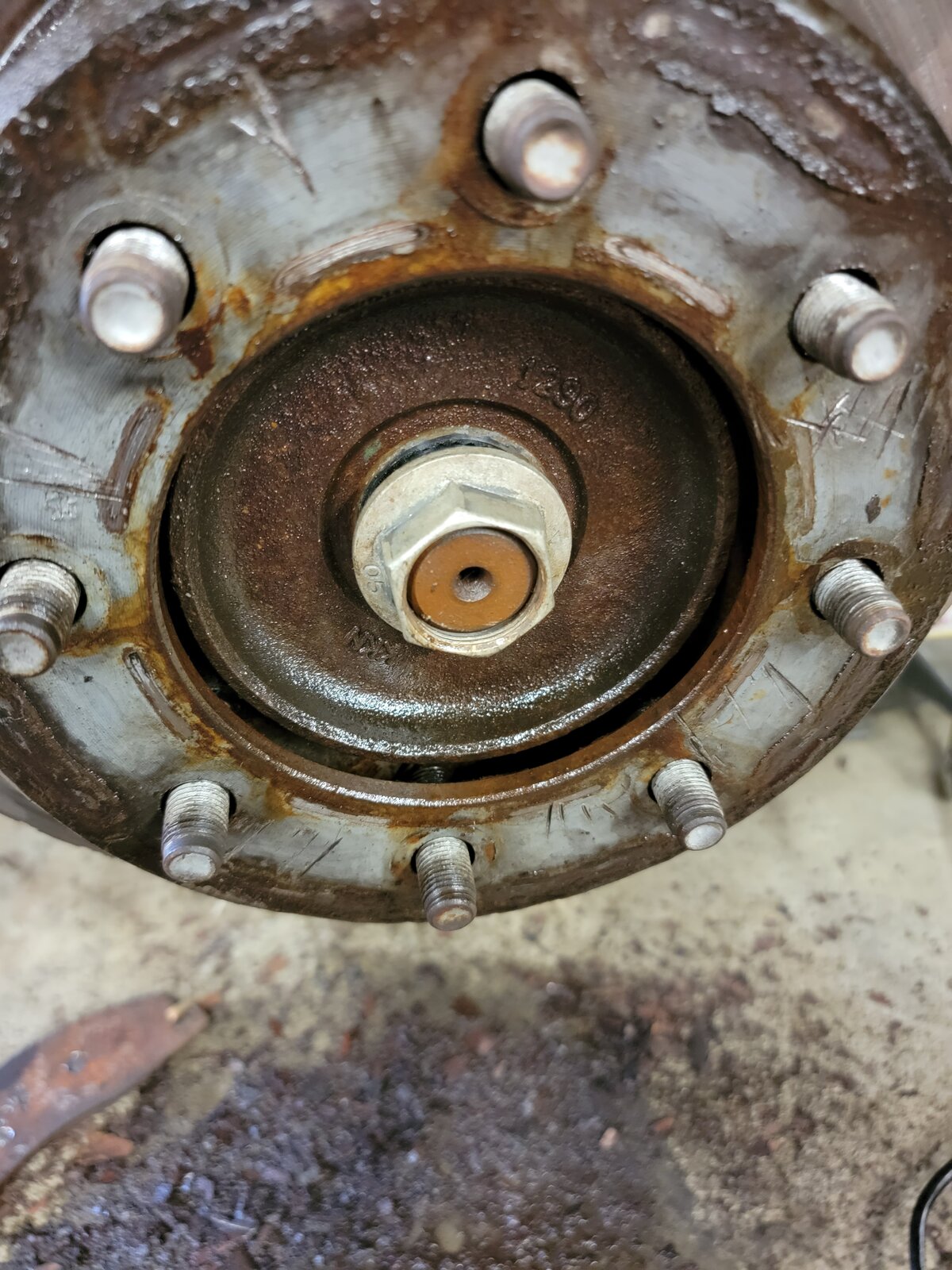

At one point I was going to remove the entire hub and deal with it, that's why the axle nut is loose.
Hub removal on the passenger side was not in the cards, you have the ABS sensor of course, and the lower front bolt has the steering linkage in the way. Push come to shove of course there are ways around all of that, I just figured overall would be faster to brute strength this thing.

The passenger side outer pad froze up and destroyed it self. The caliper slides were in great shape, they have a really nice design feature to them and the boots and pins were in really great shape.
I don't pull a trailer much in the winter, so there was some growling from the passenger side, I knew it was gone.

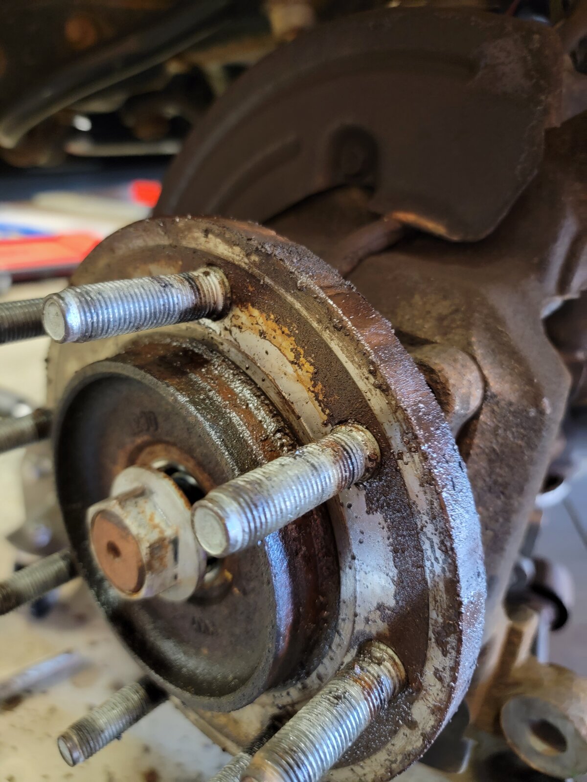

Here is what I was working with. On the passenger side.

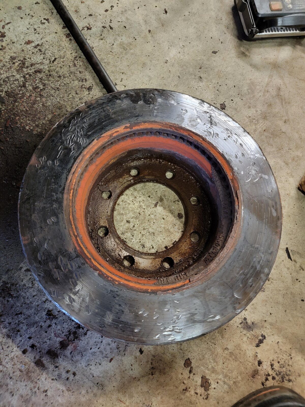

On the back side of the rotor there was a huge interference with the hub. No level of beating made any progress. The 8# maul actually broke on the drivers side so had to stop every once in a while to repeat that.
Finding that caliper bolt trick was invaluable but again it was still movie magic as that was only part of my issue. Once I cracked the rust from the hub to the rotor it still would not budge.
The caliper trick, I used the old pad and you take a bolt and back nut it between the rotor and mounting bracket, this is the large 17mm dia hole. Then the nut will hold the bolt tight then you run the bolt in and it pushes out the rotor. There was a ton of pressure on this thing so use caution, I thought I was going to snap the hardware. I also worked it around a little bit, and at this point it was being sprayed with Kroil for many hours.
You can tell the Kroll was working by the sound the oil would make spraying in the stud holes, and you can see it visually would enter the hole.
Once broken loose it was more work but faster to beat it off.
Here are some shots of this rotor. At this point it's still stuck as can be, it's not hung up on the studs they were not damaged by all this. It was inching off little by little.
It was stuck on the back side. Can see where that red is showing that's all the parts that had to break away.

Axle Nut torque was listed 132ft lb, rotate 5 to 6 times, then 263ft lb. I never unseated the hub, but followed the values I had anyway. Doubt it needed that step torque for just taking the nut off. The nut seemed reusable, I seen some that are not. Ford focus has this odd cage deal that kinda destroys it self. I did not see any special thread locker on this nut.
