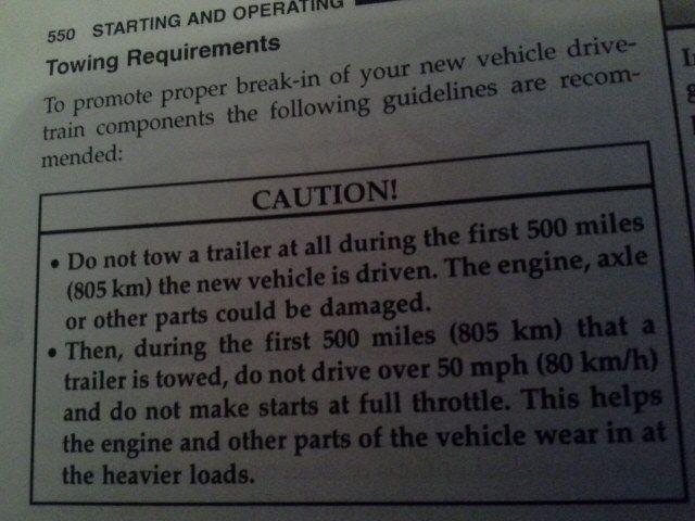

[h=1]Towing Requirements[/h]To promote proper break-in of your new vehicle drivetrain components the following guidelines are recommended:
CAUTION!:
  • Do not tow a trailer at all during the first 500 miles (805 km) the new vehicle is driven. The engine, axle or other parts could be damaged.
  • Then, during the first 500 miles (805 km) that a trailer is towed, do not drive over 50 mph (80 km/h) and do not make starts at full throttle. This helps the engine and other parts of the vehicle wear in at the heavier loads.

This is verbatim from my 2014 RAM 1500 / 2500 / 3500 Owner's Manual (Fourth Edition, page 600) *AND* in my 2014 RAM Truck Diesel Supplement (First Edition, page 223).
It all boils down to this,if you do everything in your power to do the right thing the odds are much better your truck will give you better service throughout its life.
I will try one more time. I have a 2014 Ram 3500 6.7 Cummins Megacab. I have a manual thats states nothing that you have referenced. From the 2014 to the 2016 manuals things have obviously changed. I will look one more time in MY manual to see if there is anything on transmission ,and axle break-in. I have no doubt about the break-in, but if say a new owner of the 2014's didn't know that ,and read what I read in my manual, it seems okay to just hook up ,and go with towing. Am I right or wrong ????????
There is more than one manual for our trucks. You should have the general operators manual one AND the Diesel Supplement. The general one has the towing break in that everyone is referring to. You don't have all of your manuals.
