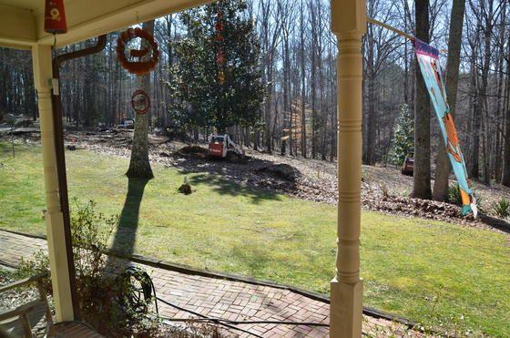

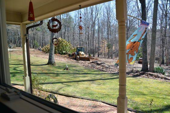

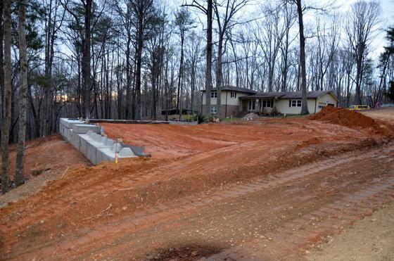

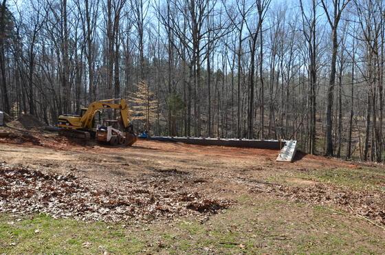

Finally, last weekend we started breaking ground for the new shop. We decided to have a Morton built sized to 30'x45' with 14' walls built. It is going to be finished inside, out, and be insulated with R40 roof and R20 on the walls. There will be two 10'x10' overhead insulated doors. I have a Carrier split system heat pump on order to heat or cool the shop. Can't wait to start bringing some old Cj-5's back to life. I also decided to install a Mohawk 10,000 lb two post lift, I'm getting to old to be crawling around on the floor to work on vehicles. I also want to thank Mr. Poe for all of his advice on the subject. I'll update as it goes up. The building is due to be dropped on the property April 15th.

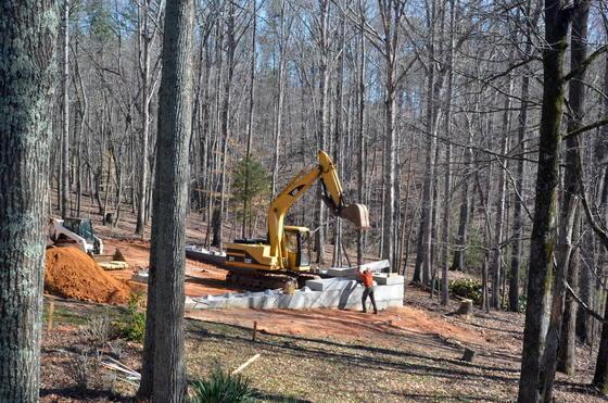

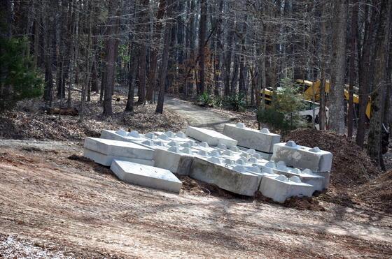

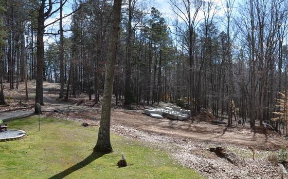

We are also building a retaining wall for the back and right side of the building out of interlocking cement blocks 6' long by 3' deep and 2' high. They weigh approx 5,500 lbs apiece and we are figuring 38 of them to build what will be L shapped. There are flat top blocks for finishing off the top of it.

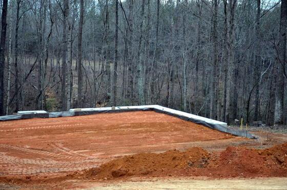

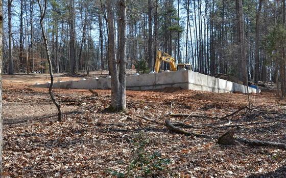

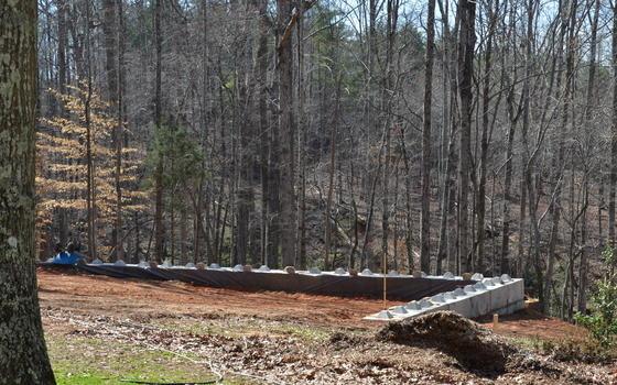

As of Sat the wall is almost done. We need to haul in about 12 truck loads of red dirt to backfill and then put the top caps on the wall. After that throw down about 5" of crushed rock and get ready for the Morton Men and concrete to come in.

Crazy Horse- those footings are unbelievable! Explain to me why you had to use the monster blocks.
The concrete blocks are for the retaining wall that the building cement pad will be on. When the building is done there will be an area of approx 7'-8' of ground between the edge of the building and the outer edge of the wall. Nothing will grow in those shaddy areas, to prevent errosion in the summer and I though this idea would be a sturdy trouble free way of keeping solid ground under the building. We can get some pretty good gully washers in the summer. Here's some of the top blocks going into place just before the last rain this past weekend.
