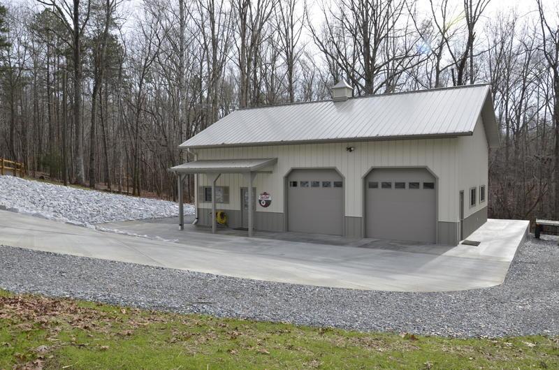

Breaking ground for shop.

Glad it all came together for you. Would you recommend Morton Buildings to others?
Bill
Yes, I already have recommended Morton to a good friend of mine who lives over in Birmingham. I love this place. And the Mohawk has already quite a few times has come in very handy for things in addition to lifting vehicles.

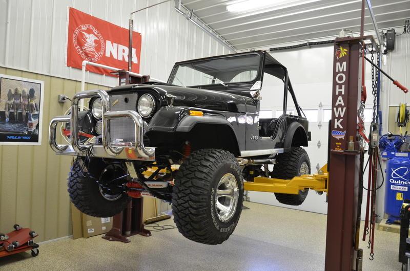

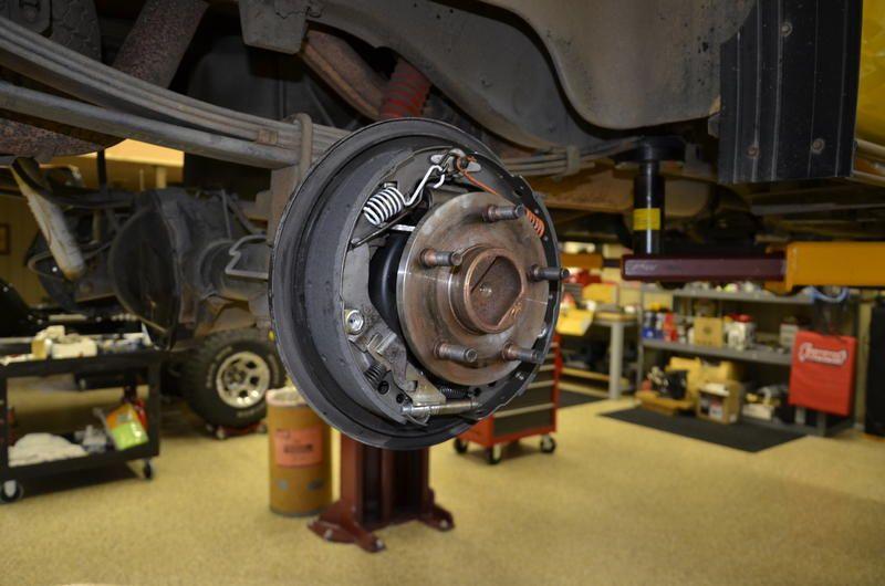

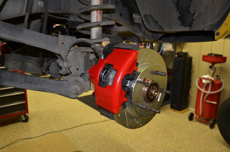

The lift came in handy again on Rose's truck for a needed all around complete brake job with new hydraulics.
Why did you solidify the granite rock in concrete? It's too permanent for my taste but I'm curious to know the reasoning behind it for future projects.
J
Two reasons mainly. To prevent the rock from moving from what ever reason, walking on, 4 wheeler??, and completing the ground seal against water. I wanted a trouble free wall for life. And it looks good to me, self satisfying. The steep part of the wall, all around the center of the wall approx. 30' wrapped inside angle, is also held in place with 4 rows of footers and rebar below the Rocks and in the concrete.
That is absolutely beautiful Crazy Horse. The rock wall adds a nice touch and with all the rainfall you mentioned I'm sure will help immensely with preventing erosion over the years. Very nicely done! That's the stuff dreams are made of!

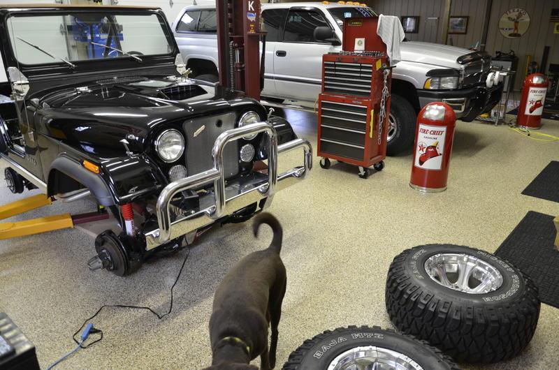

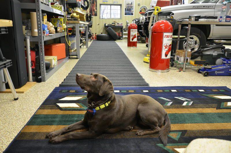

Is your shop floor textured or smooth? How does it do for grease and oil spills?

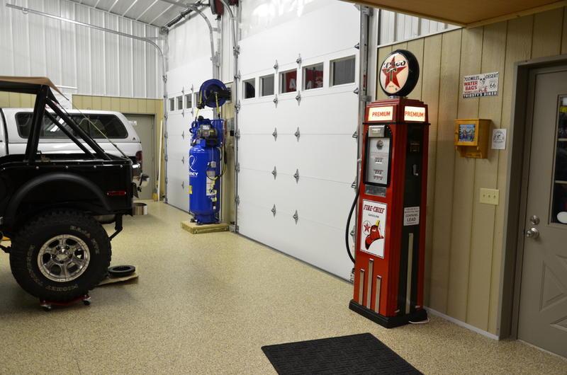

It's has a very small texture, I think just enough to give a good footing in oil or fluids. It is easy to see small screws or fasteners if dropped on the floor. I didn't know how that would work prior to coating installation, but it's no problem. The product I used on the floor was Sparta Chip and it is quite a bit more durable than epoxy, both chemical resistance and heat resistance. I have dropped a heavy piece of angle iron from waist high and could not find any kind of a make where it hit and bounced. Been keeping it at 72 degrees for the last month or so and even in the summer with the a/c keeping it at 69 the electric bill for the building has yet to go over $45. It averages around $37. These are the latest photos. I tapped a gas line for the pump so that's all taken care of :-laf .

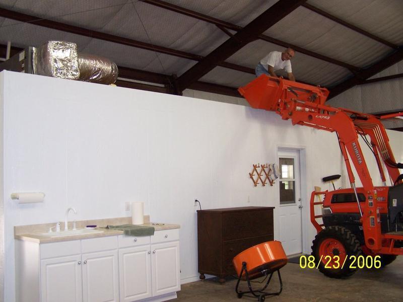

Wayne,
Sorry for the slow reply. The Loft fence has a 4' gate we put in for hoisting heavy items straight up. I haven't found the need yet to install a hoist so it all works well.

Wayne,
This is how I place heavy objects up in my loft/attic. I like the fence on Crazy Horse's loft. I'm going to look into one for mine.

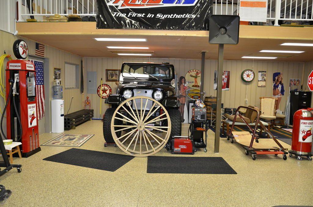

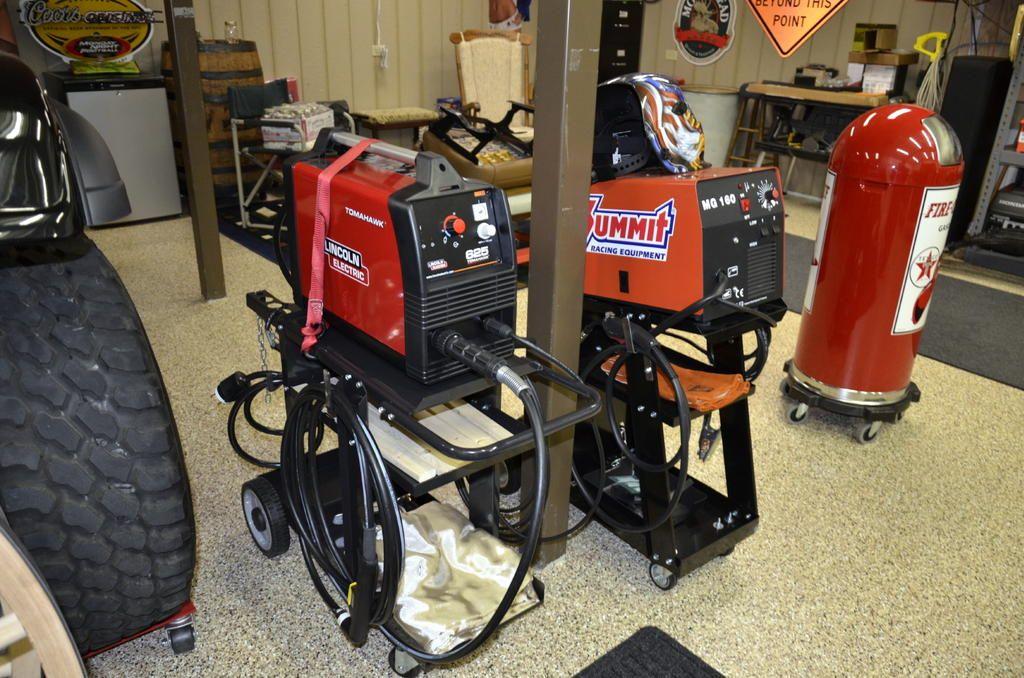

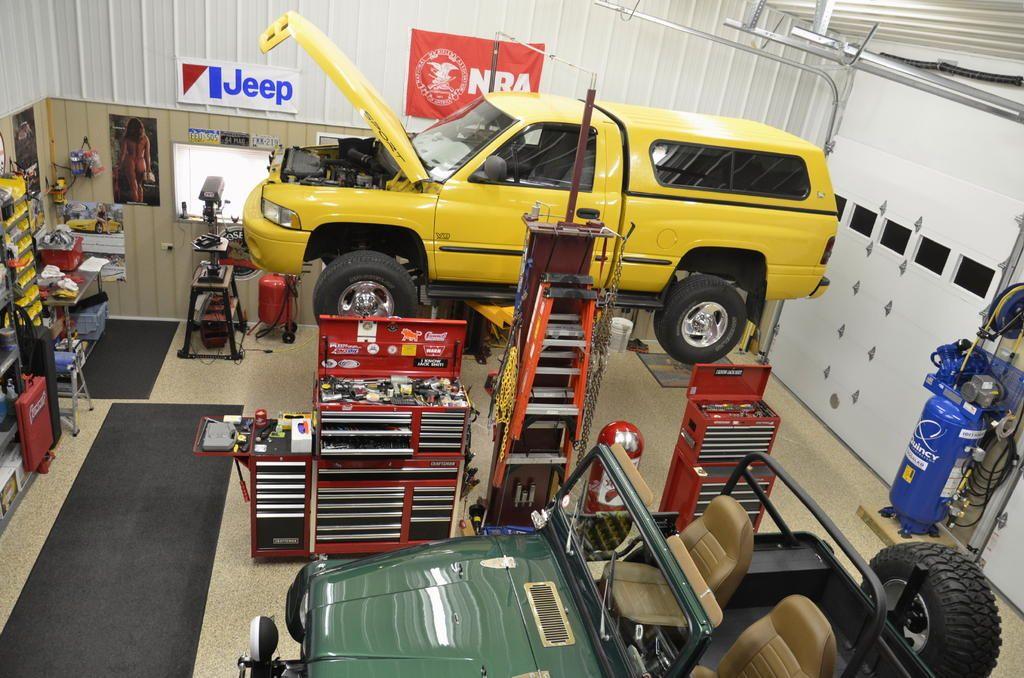

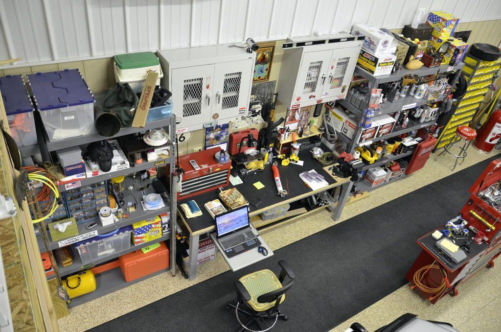

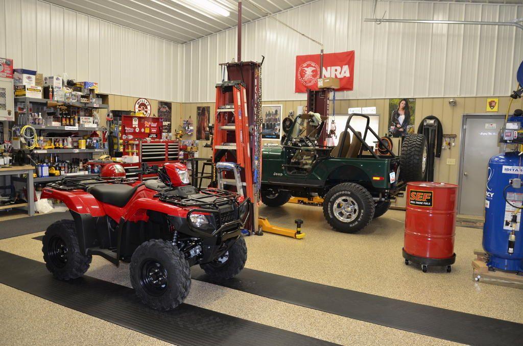

The final photos of the shop. Air compressor, heat pump, AC or heat, Welder, sand blaster, plasma cutter, stock steel all kinds, and new 2015 Foreman Rubicon 500 ATV 4x4 with independent rear suspension, 1,300 lb. towing capacity and locking switchable front differential. This is my last post since Dodge Trucks are gone, sold my Cummins, no regrets since they have the B fuels now, no real diesel, oh well leave on a positive note: This used to be one hell of a website for information, trouble shooting the old 24 valve and hop up goodies and it was fun with Robin and Robert. I'm living off my old mags right now, looking at an issue from 2007, read the article on Airbags, timbrens, loaded and unloaded. I said 4 years prior to that that the airbags left much to be desired, harsh ride empty especially on a 3500, and leaking problems. And so it goes everone with an old Dodge Cummins will figure it out just like I have in the last 16 years since my 1st 99 Dodge 3500 4x4, Cummins. Love the 24 Valve Dodge. Some of the pictures have the old 2005 Forman in them, the 2015 has the black wheels. Everybody Take care!

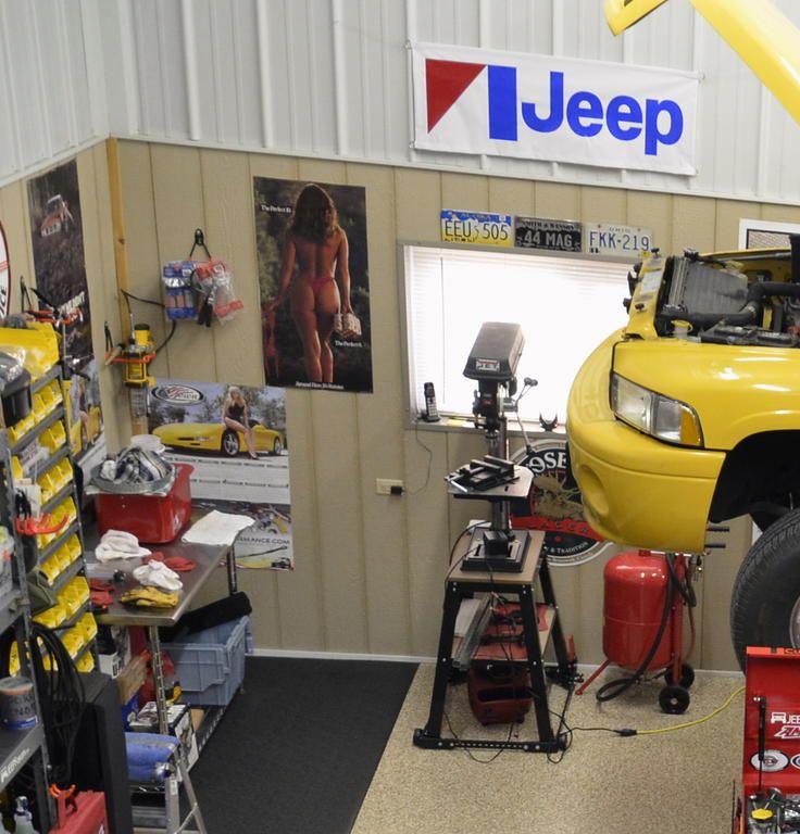

I will take the helper to the left of the drill press/window! Looks like she is walking out on you anyway! SNOKING
Except my real wife putting up with a 60 year old child, they have always come and gone over the years, except my Rainier Beer Girl that I've had since the early 80's. "The Perfect 10" carrying "The Perfect 6".

What a coincidence! lol. Thanks again for all the advise. I wound up being able to use the same panel outlet for the 220v on the plasma cutter, and the mig welder. also made up a 40' extension cord hard wired so I can take outside if need be. Also put a vent door sliding opening to run extension air hoses out side if needed or exhaust hoses for running single or dual exhaust inside with the doors down. And yes I love my Mohawk Lift, a little spendy but worth it when you get load on it. It's a handy helper as well, got a 55 gallon drum of 94 octane racing furl on a pallet loaded onto my 4 wheeler trailer out by the road. Backed the trailer into the shop and put the rack legs in as forklift forks and it worked perfect. Lowered it down and set the drum right in the dolly with wheels to move it around if needed. Also got a 15 gpm. 12 volt Fill-Rite Pump for it that's going in tomorrow. It came today, just in time to put some Real Gas in the new 4wheeler.
