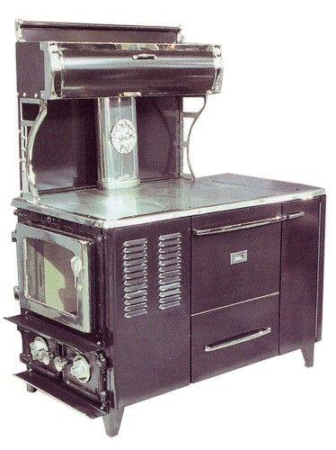

This is a pick of the stove. The wall in the kitchen it will go against has got an opening on each side that leads into the dinning room and great room. there is way more than enough space to store some wood next to the stove and just a few steps passed the wall opening is the outside deck for more wood storage. Im sure that what ever she wants to put on the walls will go from wall opening to wall opening floor to ceiling

That's almost too pretty to use! Reminds me of days at my grandmothers' in Alagash. She cooked with wood and hauled water from the spring into her late 80s.
I think thats what she is going for the* Grandma's house* we recently became Grandparents. As for the water IM NOT GOING THAT FAR on the right side of the stove is a hot water reservoir of 15 gal of hot water that will be plumbed into the water supply to the house. She will be surprised for sure.
