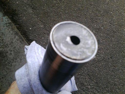

So, out it came again much to my joy. Jason once again helped me out by referring me to a transmission man he said I could trust, and he tore it down while I watched. It didn’t take long to find the broken intermediate shaft. Again, shaft was stock. I went ahead and mailed the torque converter out to be opened and cleaned so I couldn’t regret NOT doing it. Everything else in the transmission looked EXCELLENT, clutches and all.
My theory is as follows: I believe that the transfer case was to blame, that it slipped (maybe because of the corner, maybe not) and when it fully re-engaged it shock loaded the intermediate shaft enough to snap it.
