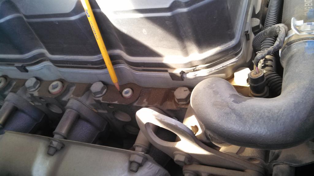

I like to open this pipe plug on the head to let the air out. Works every time for me;)
Thanks Grey Wolf. Given the suggestions I'm clearly not the only one to have had this problem. Now I have a couple of good solutions for the next drain, thanks guys.
