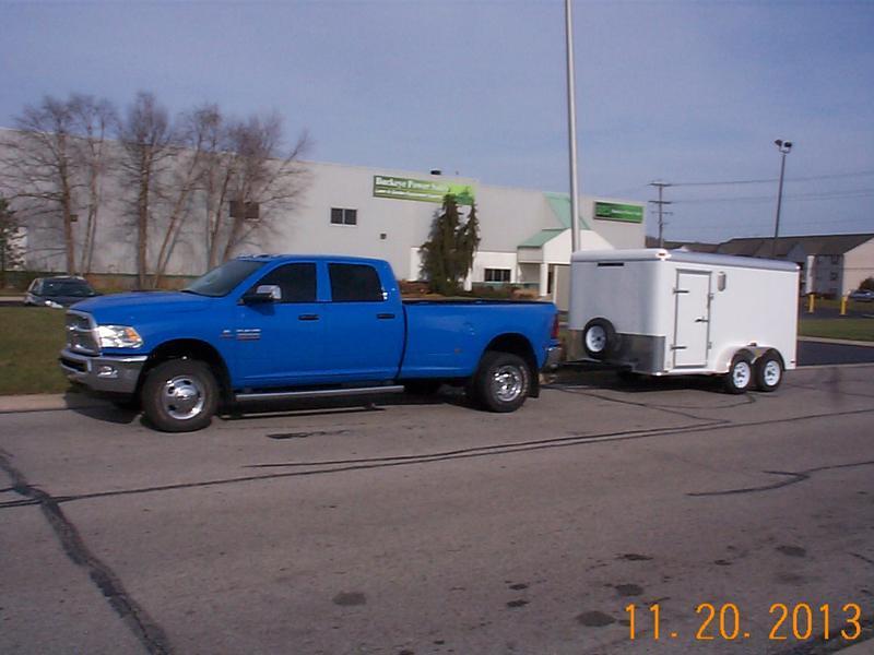

I pull about the same weight 5th wheel and recently purchased a 2014 3500. Very happy with the truck. I've only towed my 5th for a couple of hundred miles to check it out but it's almost as if the trailer is not their. I added the long side steps and I really like these to access the 5th wheel hitch. I also added a 200 amp alternator to keep my batteries charged while towing. I have a inverter that powers my freezer.
