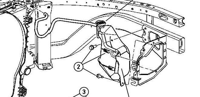

Relocating the coolant tank on a 2004 requires moving the vacuum pump from the stock location next to the battery to just in front of the new tank (from a 2005).
I was noting that I just ordered the new vacuum pump bracket for a 2005 yesterday. It has been stated that the 2005 does not use a vacuum pump, and I'm just saying that at least some of the 2005's must have used them because there is a part number for the specific bracket.
You need to look under the hood of an 05 to see why a vacuum pump is useless, parts books aside because we know just how accurate they are. There is nothing to hook the vacuum pump to on an 05, no CC servo, no bell crank, no APPS, no throttle cable.
I do have a picture of an early 2005 that has a vacuum pump in front of the coolant tank. The picture is what I used as the basis of my parts search.
I hear what your saying, but I do find it interesting that the part listed for the 2004 is identical to what came on my truck (obviously), and we had to order the small secondary bracket that I need, using a part number for a 2005. There are two unique part numbers; one fits a 2004, and the other fits a 2005 (per Dodge). The only other explanation I could see is that the 2004.5 has the relocated coolant tank and vacuum pump.
It's interesting to me that the 2005 coolant tank attaches to the large bracket shown below. That same bracket is mounted on my 2004 (September 2003 build date), but has nothing attached to it. It does, however, have the mounting points for the 2005 coolant tank.
