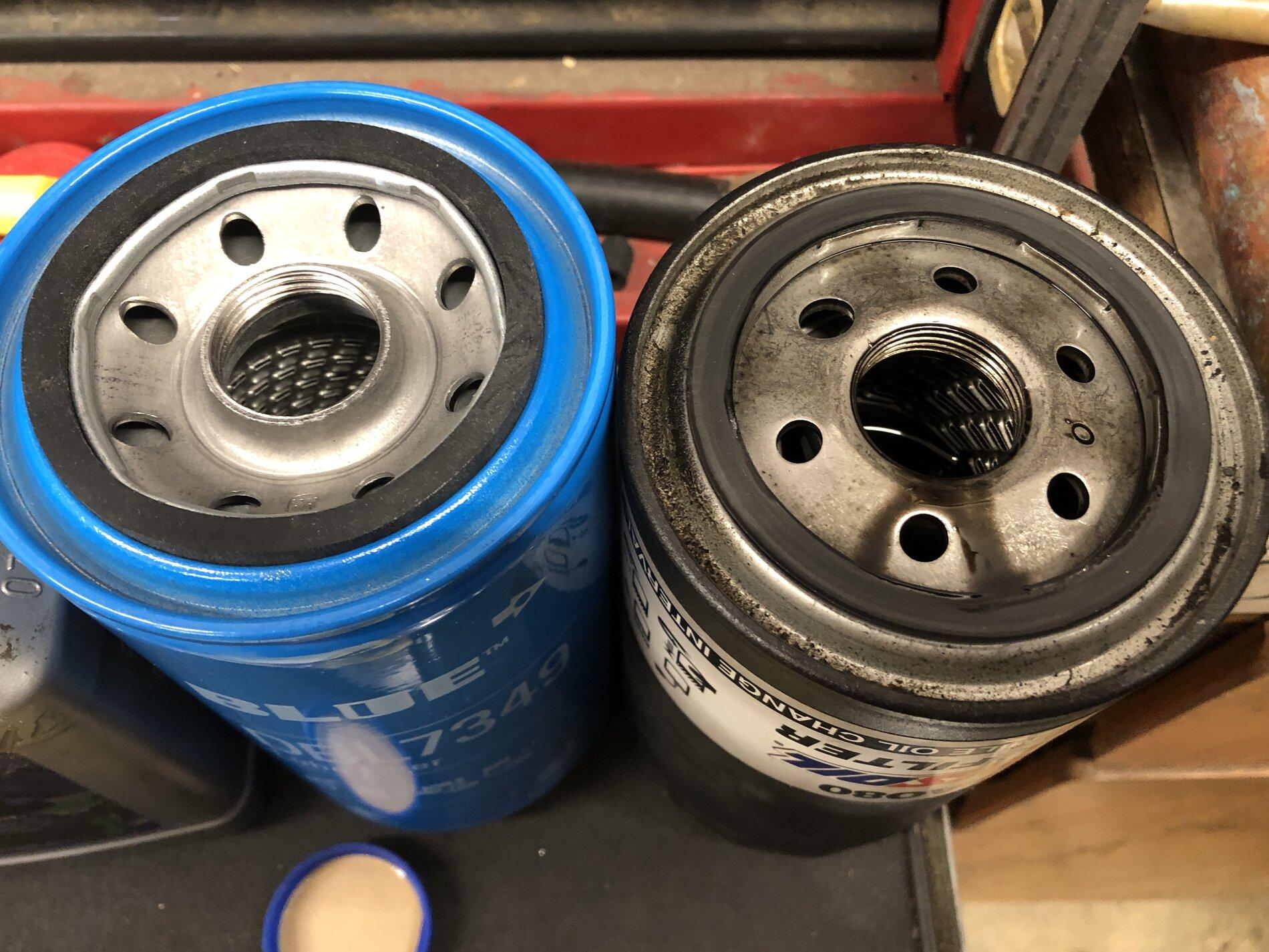

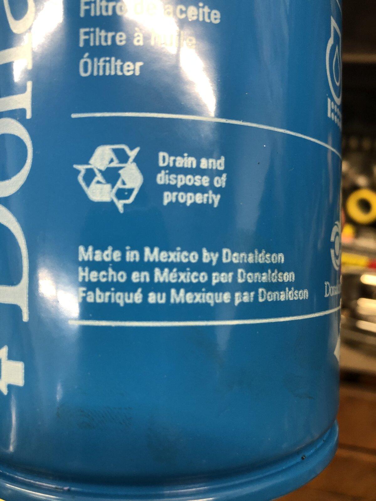

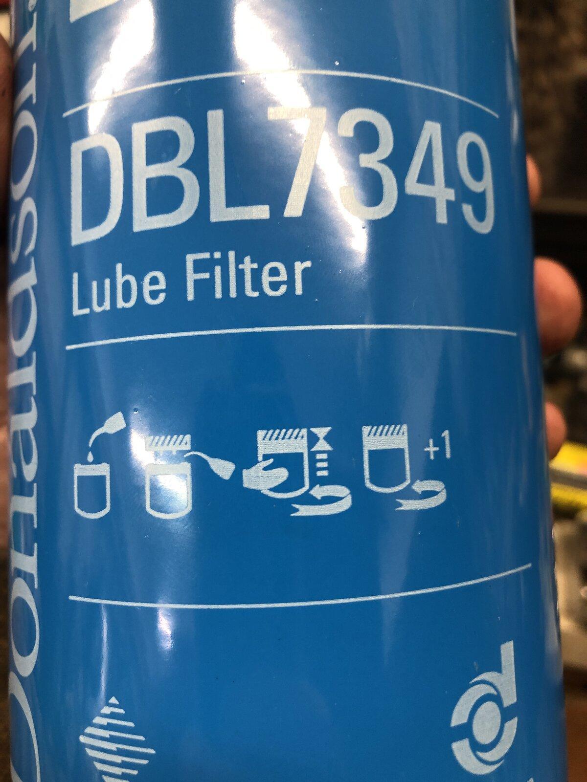

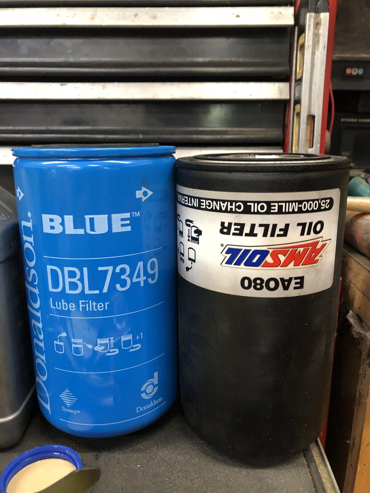

The Donaldson DBL7349 is the best full flow oil filter made for these motors.
Well I can say if available the AMZ/OIL filter is just as good, maybe better???
They sure are not exactly the same as I once thought.
Same media, or at least it used to be. The fan has always been slightly different.
Donaldson publishes 99% at 15um. The EaO80 now advertises 99% at 20um.
Great info coming in on this post. Now let me suggest that before becoming too entrenched on some make of filter, take a used one and cut it apart and see how it's built. Check the quality of the overpressure release inside the filter, is it good quality spring or just bent sheet metal acting like a spring, and filter endcaps are they quality metal or something else. Some filters may not even have an overpressure release bypass built in, in event the media becomes clogged.
These motors don’t use a clogged filter bypass in the filter since the bypass is built into the filter head. If the filter has an internal bypass it’s not really built for this motor.
Speaking of specs, did you know that the Fleetguard filters not are rated for the same flow the oil pump is? Really surprised me, but it’s one of several reasons I run the Donaldson.
