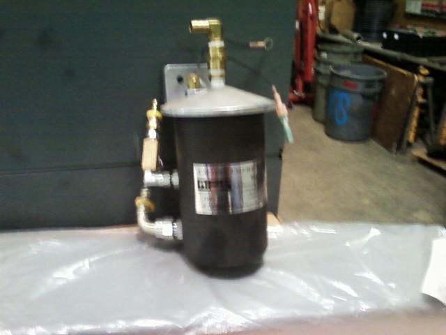

I ran an Amsoil bypass for about 100,000 miles. It did not filter soot. My oil analysis proved it. There is a by pass system that will help with fuel dilution. It's called O. P. S. It has a heater in it that helps evaporate the fuel and even coolant contamination. I can't justify the expense on our trucks. Dino oil and 5000 mile changes for me.
Mine doesn't filter soot either unless the particle is bigger than 2 mic then it captures that. I have one of the OPS filters on my International truck I had a picture of it but cant find it. Mine doesn't have a heater its just a filter that actually does a pretty good job. The oil in the International actually stays amber, I have been told the reason the Dodge wont is that it has another injection event of fuel and that is what causes the extra soot build up, DOES IT REALLY???? HELL I don't know I just know it works according to the lab rat that I send my oil samples to
Someone was talking about the OPS system, I have one of the OPS 1 filters and had them send me a picture of it so I could show you what this one looks like. It filters to 2 or 3 mic and burns off the fuel and coolant contamination within the oil, don't have the info for it with me and wont be at our Seeley house for a long time but gives you an idea of what it looks like. Oil goes in from the top and out and the same way but then on the side of the filter housing it goes to another part that does the contamination burn off. Sorry for the blurred picture It wasn't me taking the picture. Borrowed this filter from where I used to work forgot that I had it but this was for trucks that had a RE-Gen system. I will take it back some day :rolleyes: MAYBE!!!!!

If soot is your only concern, then don't bother with a bypass filter.
Yes, you need to change the oil more often because of designed-in dilution by fuel. But using a proper bypass filter will remove from the oil particles that are large enough to cause wear but are too small to be trapped by the full flow filter. This is the primary reason bypass filters are used.
