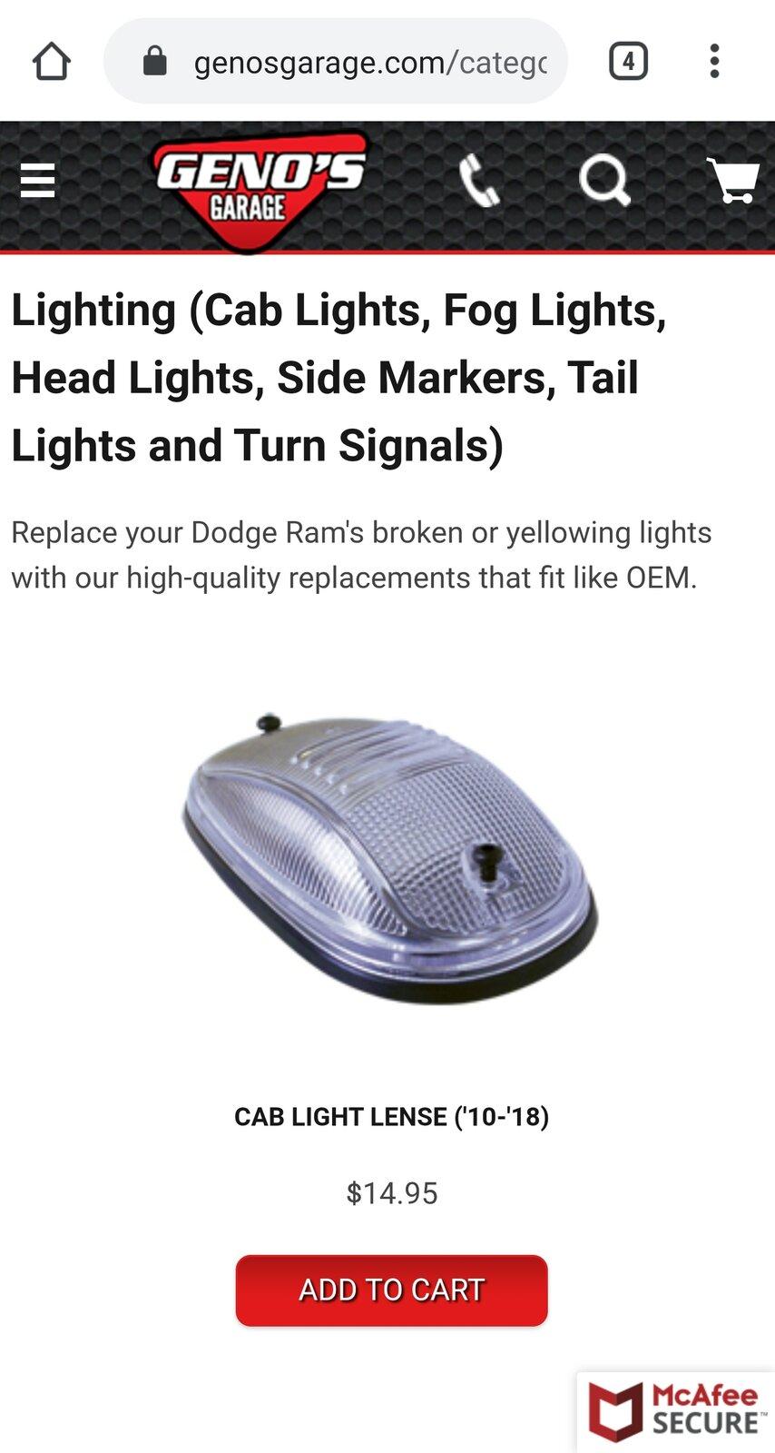

Interesting I have a set of Mopar ones I picked up for my 2nd Gen, that were the 10-18.
I see the wording on there now says fits like the OEM ones.
I did get my Mopar ones from Genos, maybe 2 yr ago, maybe they are not OEM anymore?
Never did get around to installing them. My 2nd gen are pretty faded and shot but do not leak.
Either way you might want to try one of these from Geno's, as a last resort before you weld them up.
https://www.genosgarage.com/category/lighting

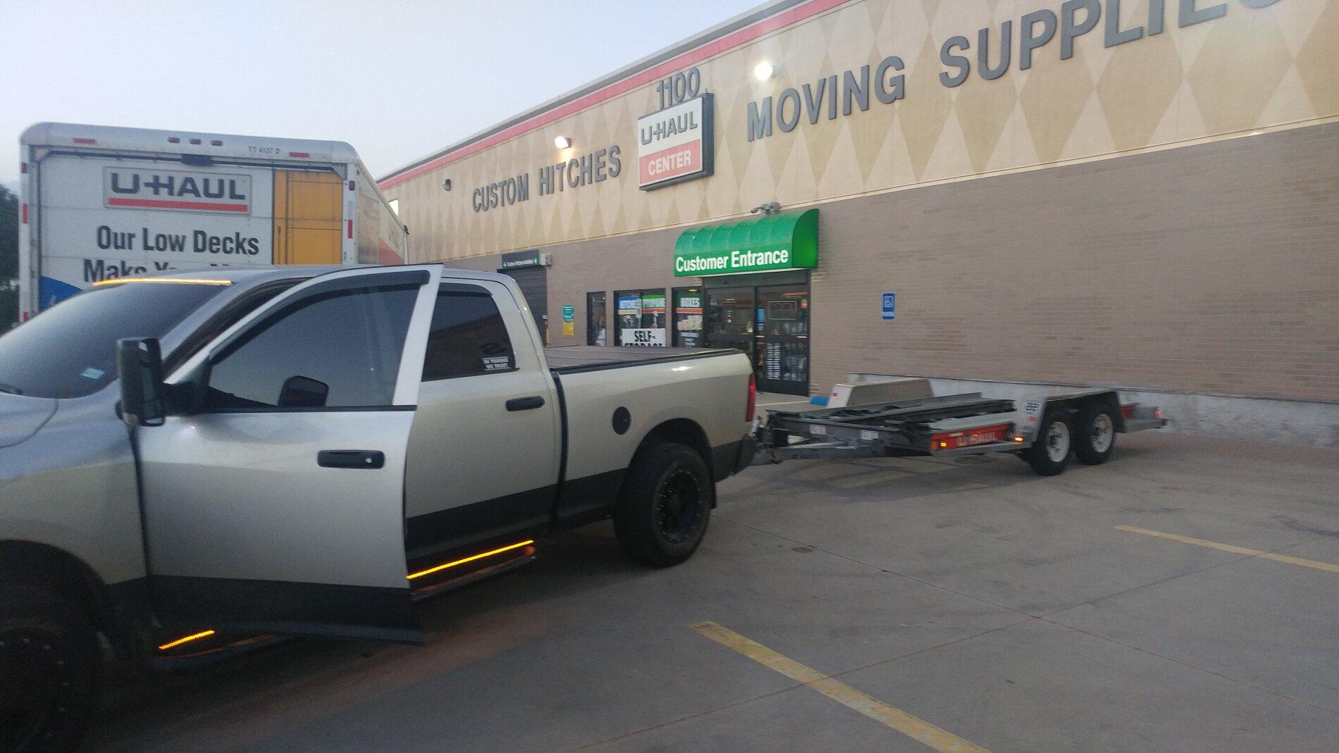

These lights I bought a week ago, I was extremely careful into how I removed the old ones, cleaned the surface, applied silicone to the bottom of lights and foam pad that came with as well as gasket maker under the roof and dabs of gasket maker to run the wires and mounting screws through just like I did with my old ones. I also made extremely sure to just tighten the screws till they stopped with little effort and then gave an 1/8" further turn.
After 3 days of Install I have condensation and several lights are working on and off within the 24 panel LEDs lights. Each light has an led board with 24 little less on it.
I want to remove these and run a solid LED strip again and I liked it better and they lasted much longer. Got 4years out of it instead of 2. See roof and sides of truck . I want to go back to that style. But I'm thinking if it's going to be too much effort to fix I won't
