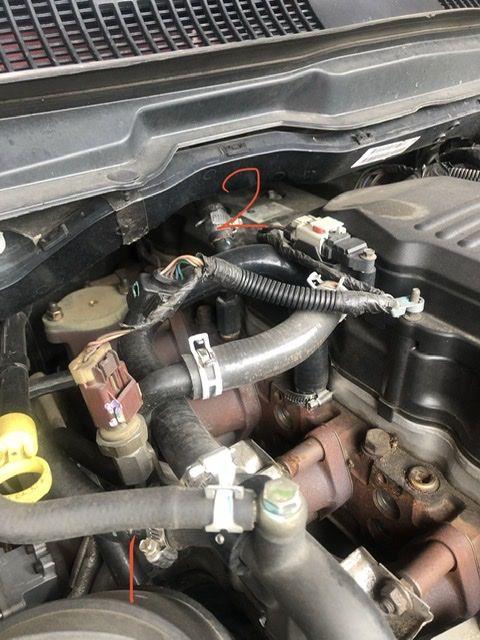

1. goes to the bottom outlet.
2. goes to the top.
if both hoses are hot then your good. no air pocket, no clog. i would bet on the blend door malfunction
Nope, if the inlet is on top then the heater core stays full with air and the hotwater inside is just like a waterfall, exiting on low. Same temperature as it entered the h.c.
