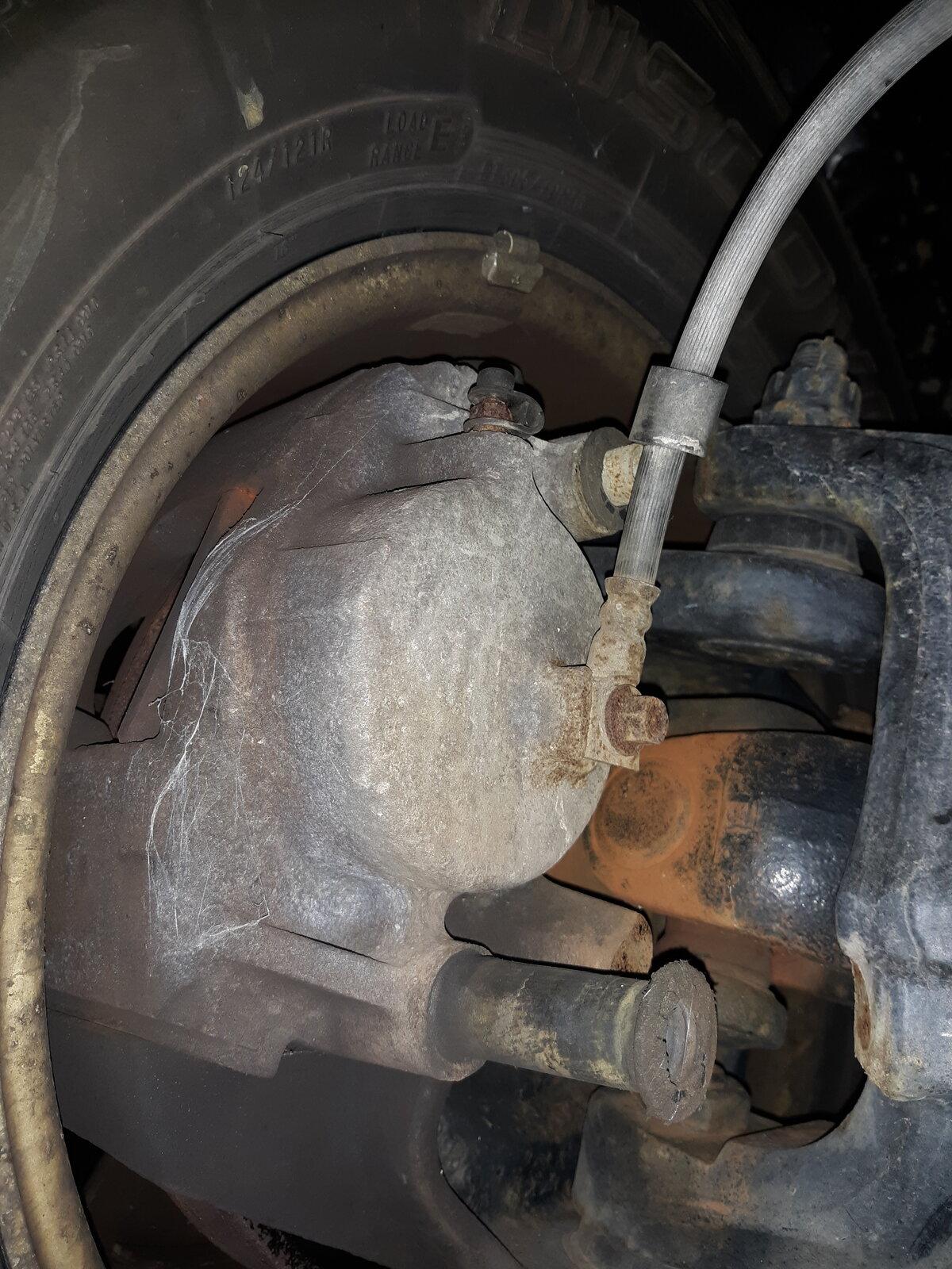

I was able to acquire a bushing for the transfer case range selector rod - Lost the original as I was tidying up wires. I picked it up today and decided to install it after I was done I figured I'm on the ground anyway might as well take a look at the left frontend and see if there's anything obvious that could be making the front left sort of shimmy above 45mph. I was just about to crawl our and something didn't look right:eek:.
I was able to just grab it and wiggle a little and out it came.

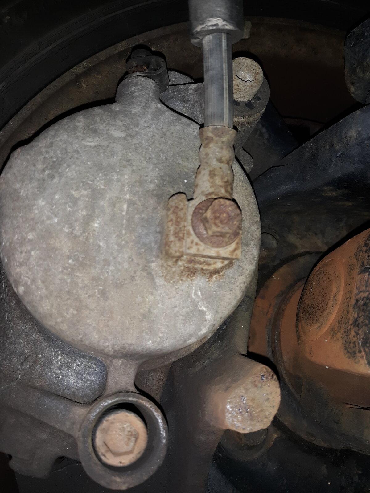

By the looks of it it appears someone:rolleyes: installed the rubbers in the caliper backwards, note the top one. Not me for sure, but stupid me for not noticing when I installed the loaded calipers that the rubbers were big end out instead of big end in (between caliper and caliper bracket).
All sorted now, wasn't able to get over 45 when I wen't for dinner, raining cat's and dogs. Will have to check right front to see if the same thing tomorrow. Think I'm going to get new hardware and just do it so I don't have problems down the road, you know - precautionary measures...
