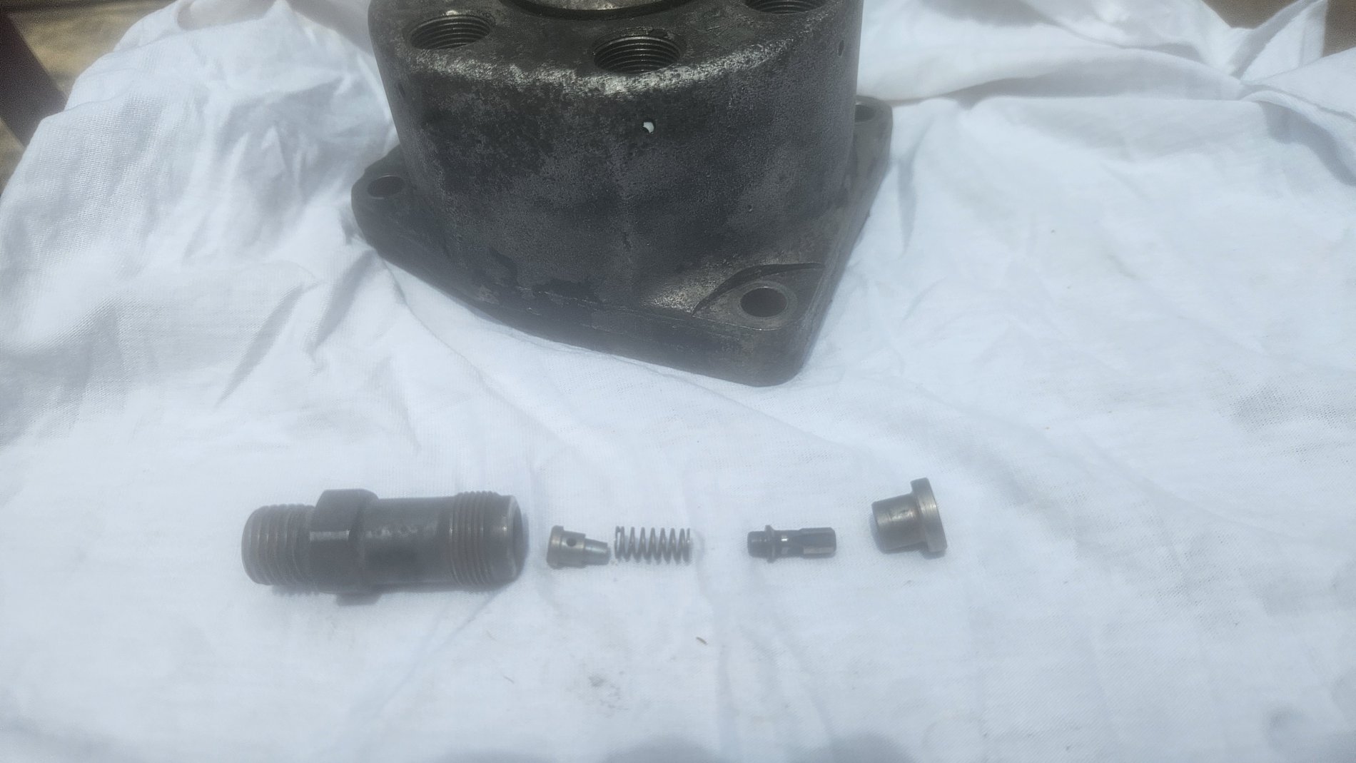

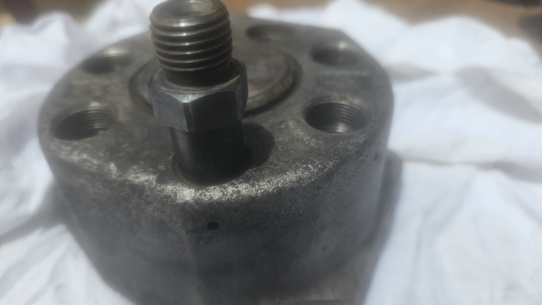

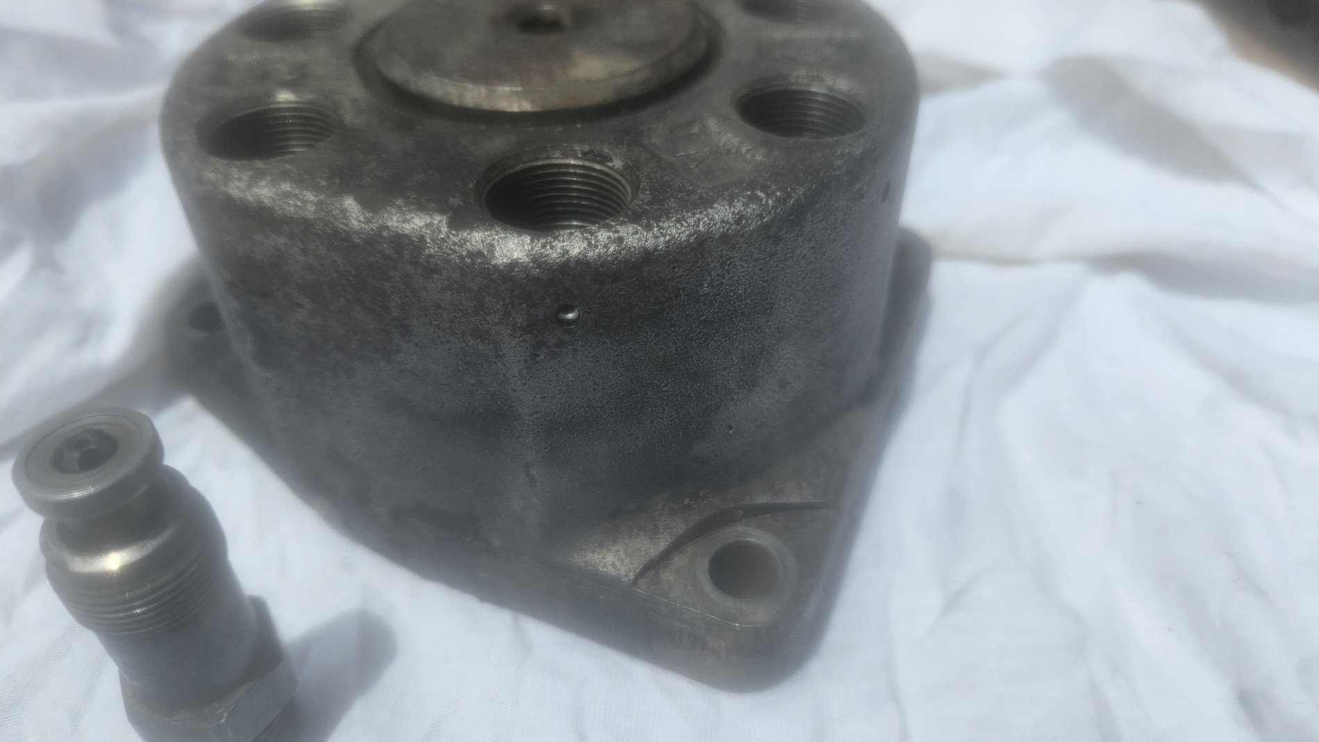

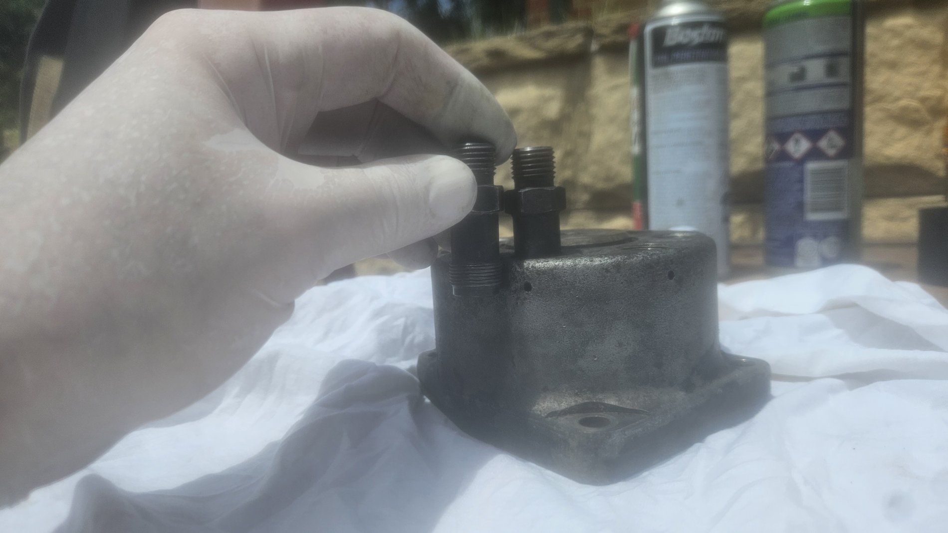

For a visual I took these pics of the old distributor module. Note that even when I turn the key to prime with the lift pump. The hole starts leaking straight away. Then after cranking a bit to start it will stall after a few minutes. Almost as if there is an open line all the way thru the pump to the main supply line.
