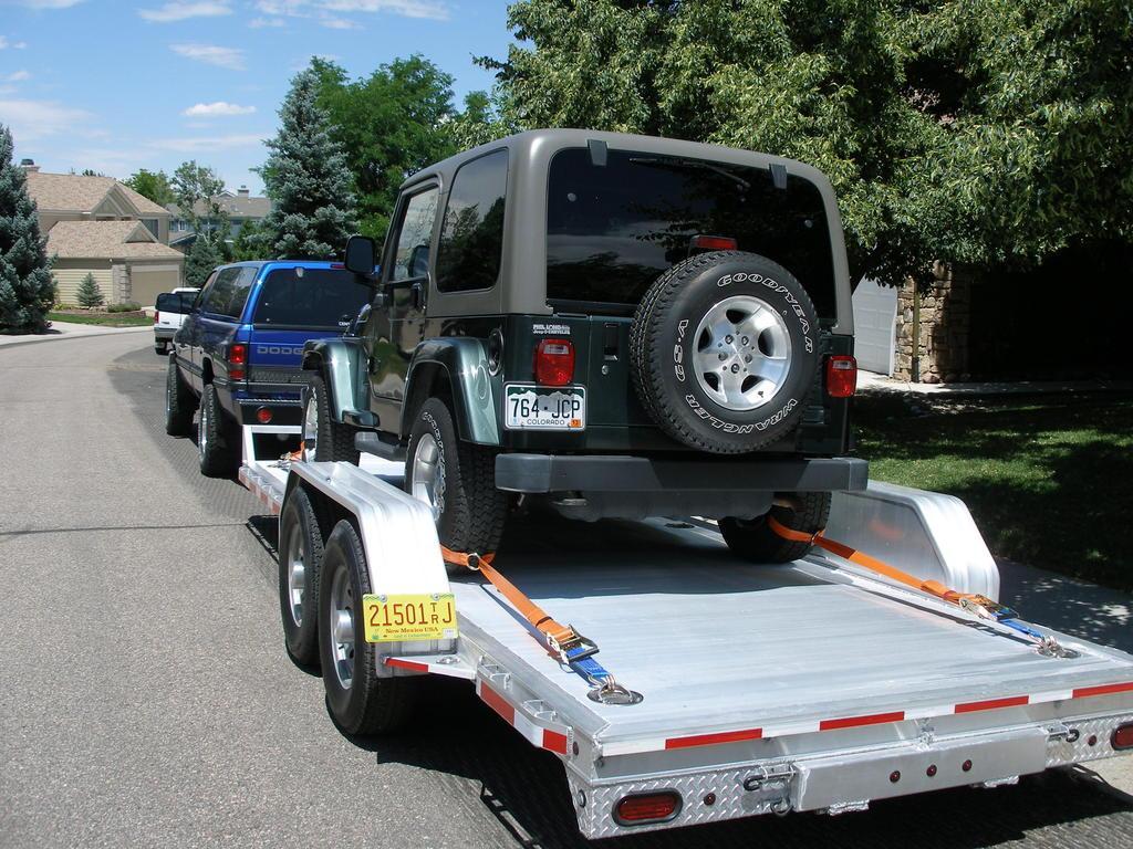

E-track is a wonderful way to go if you have the room as some as stated. I prefer to tie down at the wheels/tires, and let the suspension move. This way the movement of the suspension is not working against your tie downs. If the vehicle has some type of slotted wheels, or aluminum wheels, I prefer to use axle straps with the protective sleeve through the wheel. Hook your ratchet strap onto the strap and tie it down. There are also straps available that are called "lasso" straps that come with either a ring, or sewn loop that can be used in lieu of an axle strap. They come in different lengths and work extremely well. If you look into tow companies that have flat beds, the recommended way to tie town vehicles is with some type of connection the tire.
