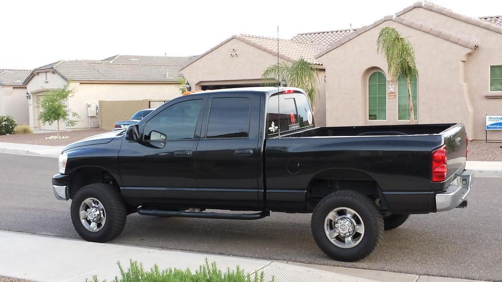

I installed the kit on Sunday morning but I couldn't resist putting the rear 5160s on Saturday after noon. So driving around sat night and sun morning with oem suspension the shocks made a huge difference in the rear. But after doing the whole kit I'm wondering why I didn't do this 200k miles ago. I have yet to get off pavement but speed bumps, expansion joints and bumps in the road are a breeze. I need 35s now, the 285s look a little small now but that will have to be in the future. Hopefully near future.

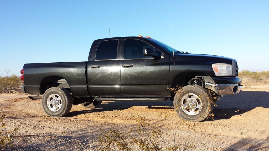

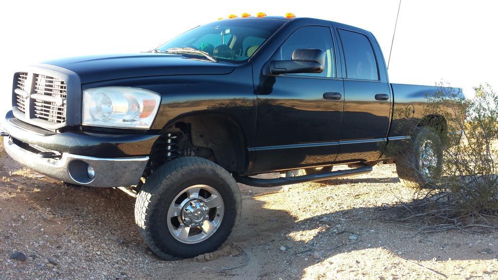

Took it off pavement today and the kit is amazing. Very satisfied and will be taking it out in the near future to run it longer. As far as pictures go I still haven't figured it out. The best I could do is attach a picture to my profile. So you'll have to check out the profile. Sorry

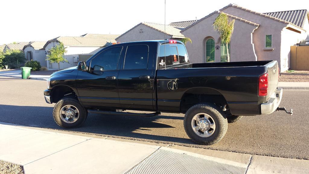

this is before with a revtec level kit
Hey thanks- looks great! Makes the 285's look like the OE size, but not lost. The silver tubes are external reservoirs for the shocks? The kit came with brackets and such to mount, or did you have to figure it out?
Yes, the silver tubes are remote reservoirs for the bilstein 5160 and the research I did on them says you get more travel and more oil which keeps the cool. The kit comes with everything you'll need. Pretty straight forward, the most difficult was trying to install bolts on passenger side lower shock mouth bolt. I had the luxury of have air tools hd floor jack, tall hd jack stands, and a couple real mechanical guys to help. Took us 4 hours not including the limiting straps. I have yet to install them due to the fact you have to weld tabs to the axle to bolt the strapt to. I have since had the welded on, just need to take tires off drop axle to its limit and drill a 1/2" hole on the spring tower for the other Mont for strap. If you're interested in getting the kit I can give you my number if you you want to call and I can give you advice and tips on the install. Price seems like a lot until you get it on the road and then off road makes it well worth it.

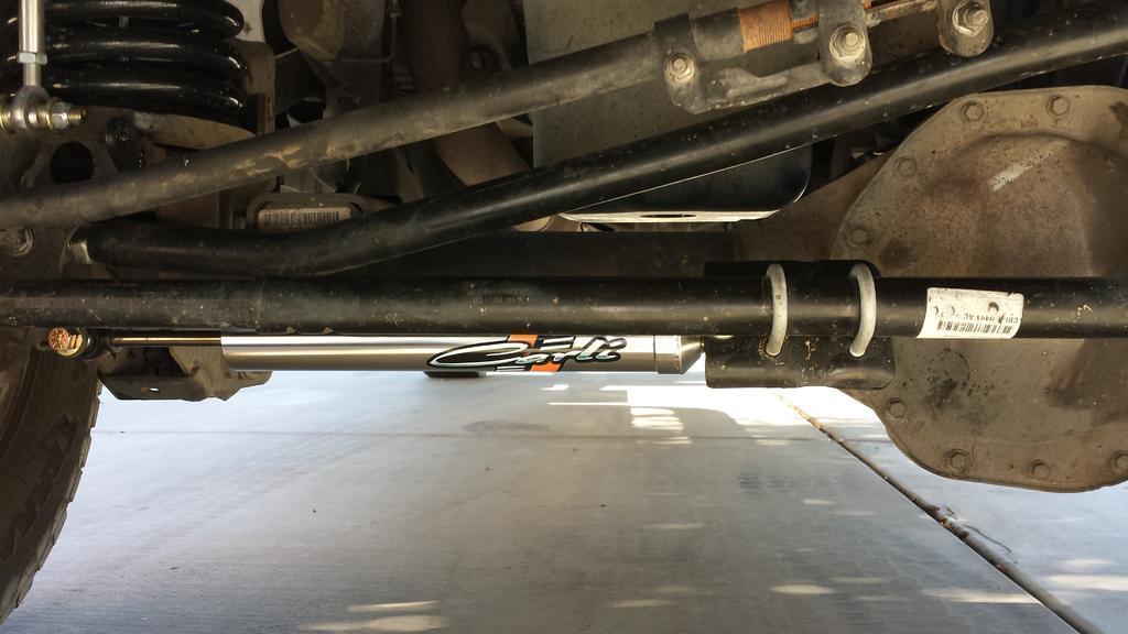

fully addicted now, I went and picked up a carli steering stablizer for the local carli retailer, started performance. Next will be the carli control arms.
