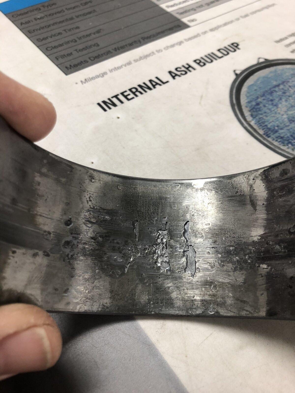

CAT 3406....what happened to this rod bearing??

As the title says, what caused this condition??
Hint....we have seen it many times on Cat engines..

Almost looks like electricity arcing to ground but I can’t figure any reason for that to pass through the crank.

I've got a 1 1/2 hour drive coming up so I don't want to leave you guys hanging...

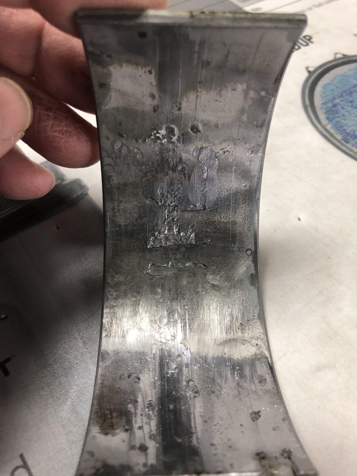

Overfull of engine oil which causes windage in the base which in turn causes bubbles in the engine oil....same effect as water bubbles against a cylinder liner...
We've seen it several times over the years...every time we ask how much oil they put in during an oil change and the reply is 44 quarts or more :(....that's not a good thing...
A CAT 3406 in a truck with a standard truck oil pan holds 40 quarts period....so a mis-marked or worn out / broken dipstick is usually the culprit...
If you look closely you see marks that look like a bb pellet hit it repeatedly. Those are from exploding oil bubbles..

Mike,
On a serious attempt to understand. Is this an overfill to where the crank throws are in the oil thrashing and splashing aerating the oil? The engine doesn't appreciate the foam and damages parts.
Gary
The same thing happens in hydraulic systems when there is a leak on the suction side. It slowly destroys the pump with miniature explosions when the entrained air is forced out of the oil.
Learn something new every day on this site. We had a 3306 wipe out the mains and the crank. Thought it was from the service Tec using RVT silicon to hold the gaskets in place. I couldn’t figure out how the silicon got past the oil filter. Seeing this pic now makes more sense. One of our oilers would overfill it when he did the morning start up.
Thanks for sharing this with us.
3306 is a smooth and sweet engine.
To me, that bearing looked like it was exposed to contamination and was delaminating.
We had well over 30,000 hours on our 3306’s and well over 50,000 hours on our 3406’s when we started to preform overhauls. They were never the same after. Quality of the parts just wasn’t the same. After seeing this pic I’m questioning if that 3306 was overfilled a few times due to people being lazy. After the overhaul they tended to use a lot of oil...
