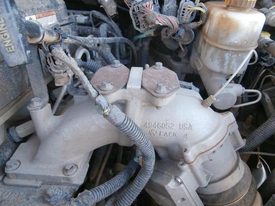

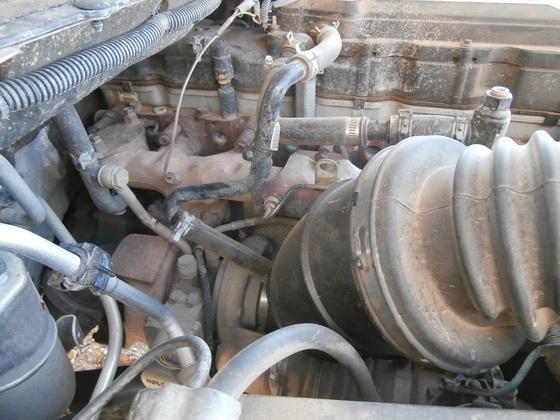

The third photo shows a hose going to the air intake that looks like it's still open on the end. Is that the case? I haven't looked at a 6. 7 in at least a couple years.
That had me foxxed as well. I studied the photo on a larger screen and it's an optical illusion. What we're seeing is the band clamp around the hose.
