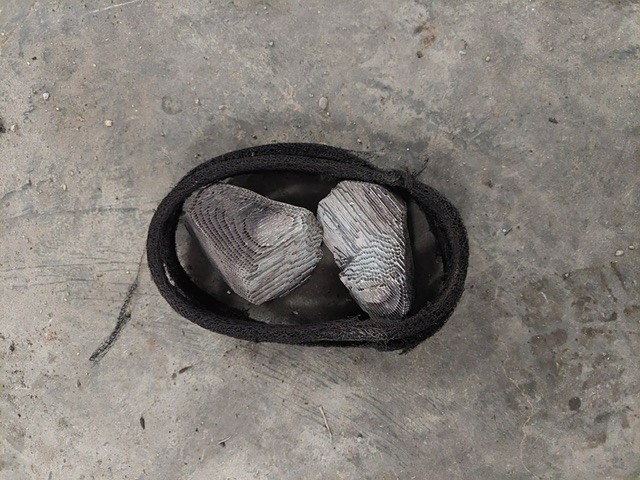

Cats are normally “self cleaning” and don’t stop up unless there’s a problem. For instance, we had to replace the cats in my son’s Mustang GT a few weeks ago. The LH cat had come apart and pieces had blown into the mid-pipe and stopped it up. Very unusual. This is what we found in the mid-pipe.

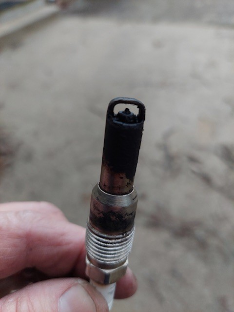

I suggested we pull the plugs and see what they looked like. We’d just replaced them in July. All looked good except #8, LH rear cylinder. This was from a bad injector dumping gas. This is what took out the cat.
