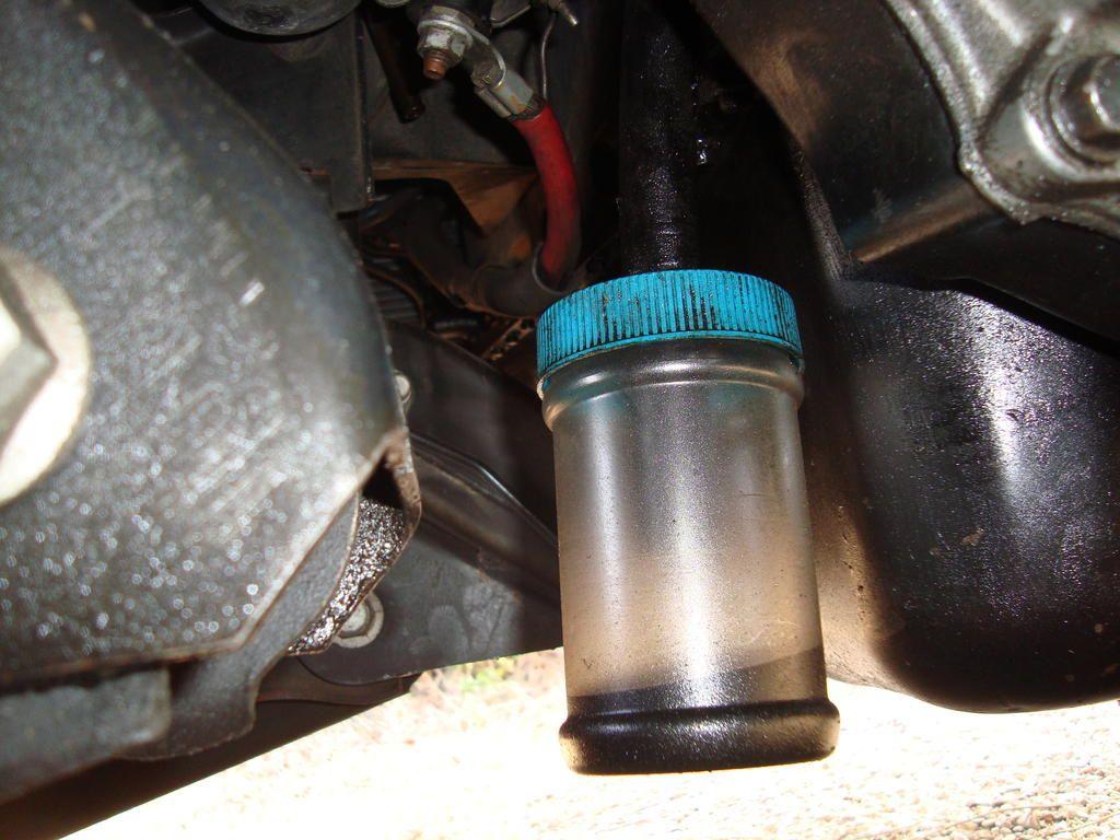

I don't know that there is a real need other than keeping the underside and garage floor a bit cleaner. I have a bottle on mine and it definitely helps me track down the occasional oil seep source by ruling out blow by from the crankcase. The build up in my bottle is pretty minor but I do check it and usually clean it out annually. I think changes in the amount collected may help alert me to the wear status of the rings.

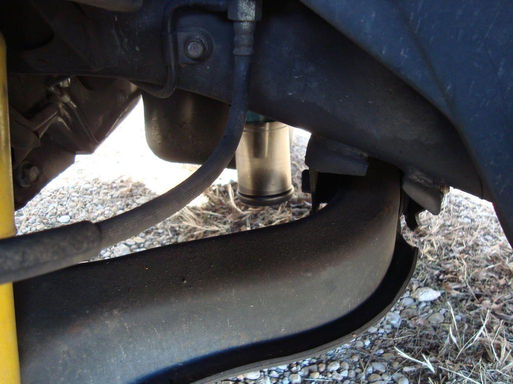

Kept a jury rigged catch bottle on my '98 12V nearly all the 100K+miles I had it. Strictly to keep my new garage floor clean. Never did collect much more than a few drops but at least they were contained.

I installed many of these "Catch bottles" on so many 12 V engines, I can't count how many! They do provide a much cleaner underside of the truck!
A catch bottle can be had for next to nothing. I use a plastic 16 oz peanut butter jar. Drill a 1 inch hole in the top to slide over the draft tube and 5 or 6 1/4 inch holes to allow the air to escape. Slide the cap onto the tube and place a zip tie under it to keep it in place with the bottom of the jar about 3 inches from the bottom of the tube. Screw the bottle on and empty when needed.
