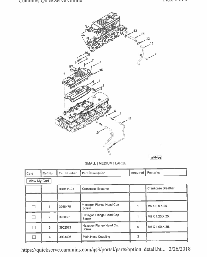

funny thing is getting rid of the CCV filter has to be one of the biggest wastes of time ever fomented on the Cummins Driving public.
the people who claim it reduces oil getting in the turbo also don't know how the CCV system works..
it functions as an oil separator and returns any oil that does happen to get in the filter
back to the sump. #10 and 11 are the oil returns to the sump.. even have check valves in them..
