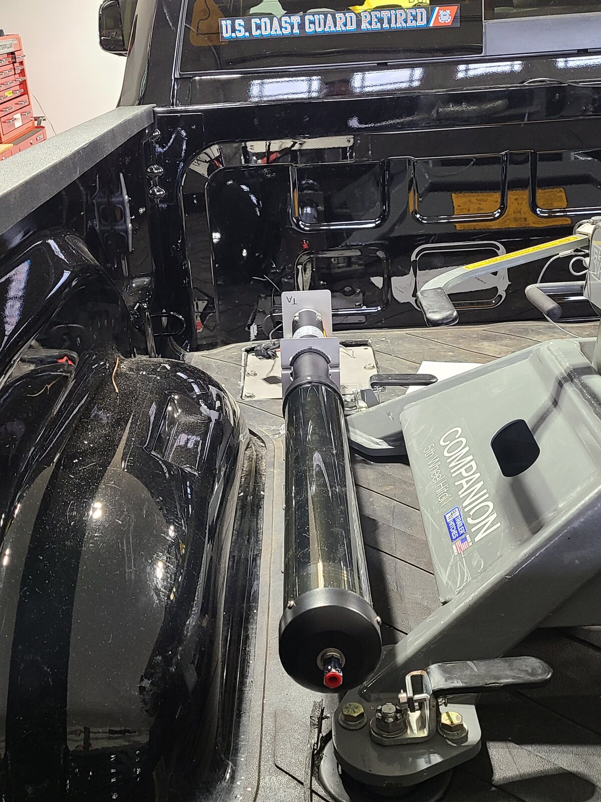

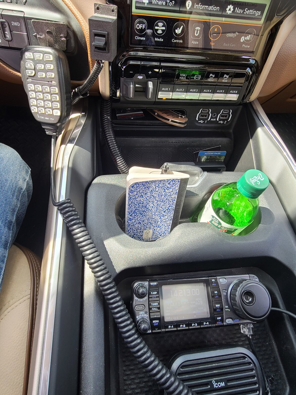

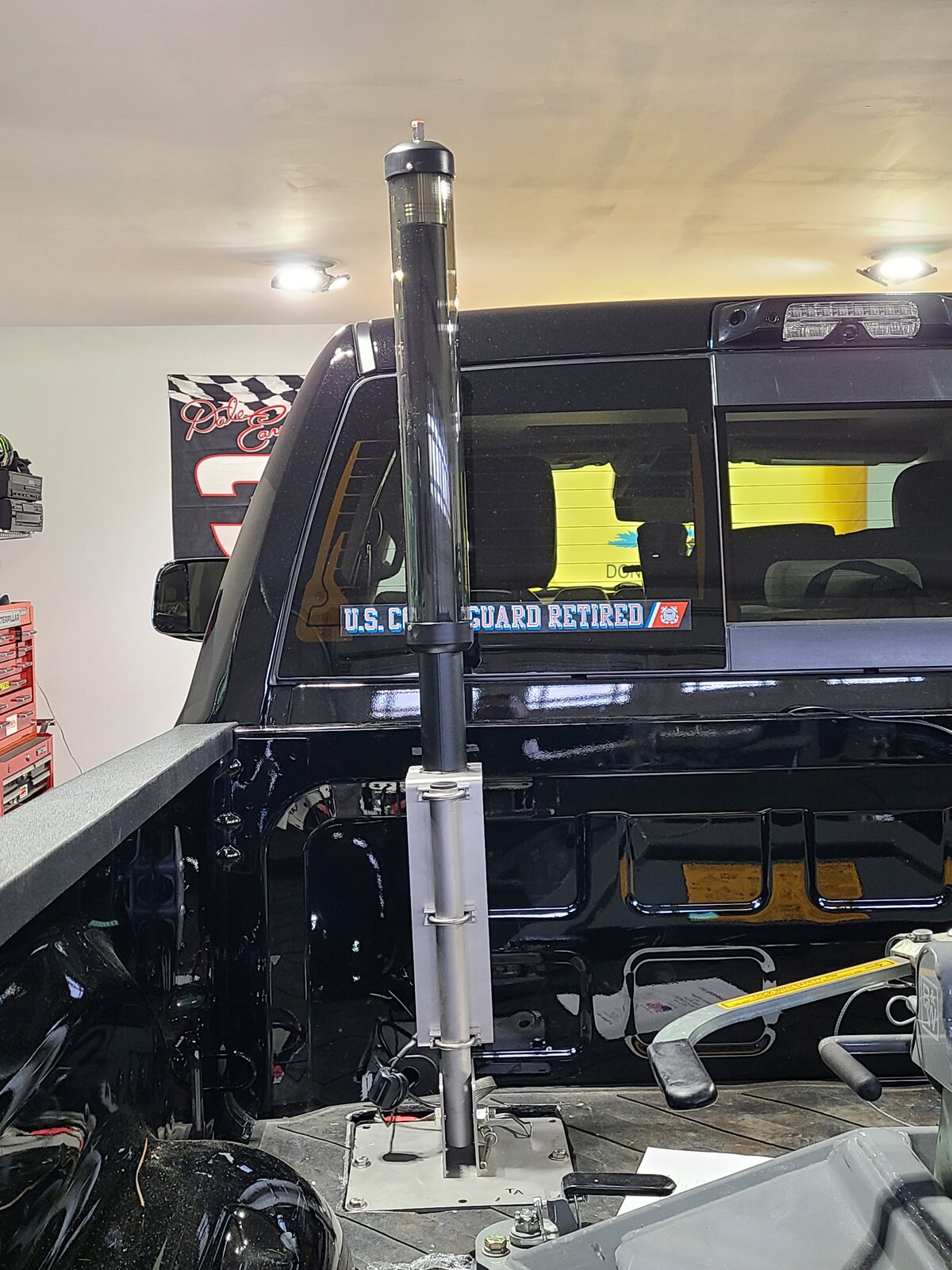

I run an Icom 7000, tunematic II auto tuner, and a Tarheel 100 HP antenna with a tilt over base. Lots of 1" flat braid straps on frame, exhaust, bed, hood, etc.
I ran the power wires through the firewall . I found a vacant plug where the clutch pedal would have been . I drilled the hole larger. I also used one of the accessory switches. The coax cables, go through the bed, and through one of the cab vents behind the rear seat. Had to remove left rear seat to do this, but it ain't that bad. I also have a mag mount 2m/440 .
