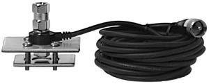

Can anyone tell me where I can find a no-drill CB antenna mount solution for a 13/14/15 Ram 3500?
On my 2001, I used one of these stainless steel hood lug mounts which worked well...
I'm not find anything like that for my 2014. I'd really like to avoid a magnet mount antenna if possible and I also don't like the idea of drilling holes in my still-nearly-new truck!

http://www.cometantenna.com/amateur-radio/no-holes-mobile-mounts/antenna-mounts-and-brackets/
DG2ANTPF.....5th one down.
I've been looking at one as well; I currently have a magnetic mount on the headboard of the bed, but I believe that's the worst location possible. I'm sure the SWR is through the roof.....being that close to the cab.
I've used these on my 2011 with no problem for my ham antennas. I did add a screw in the lower channel to stiffen them up. I took one and tweaked it so that it would fit on the right side.

The hole on that mount is too large for normal CB antennas, but a couple of stainless steel fender-type washers should solve that.
