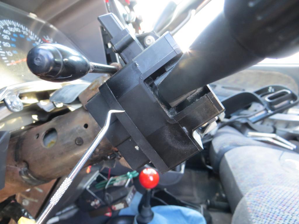

Pic1 shows column stripped of the wheel, covers and harnesses. Pointer at turn signal/hi & low beam/wiper-washer switch.

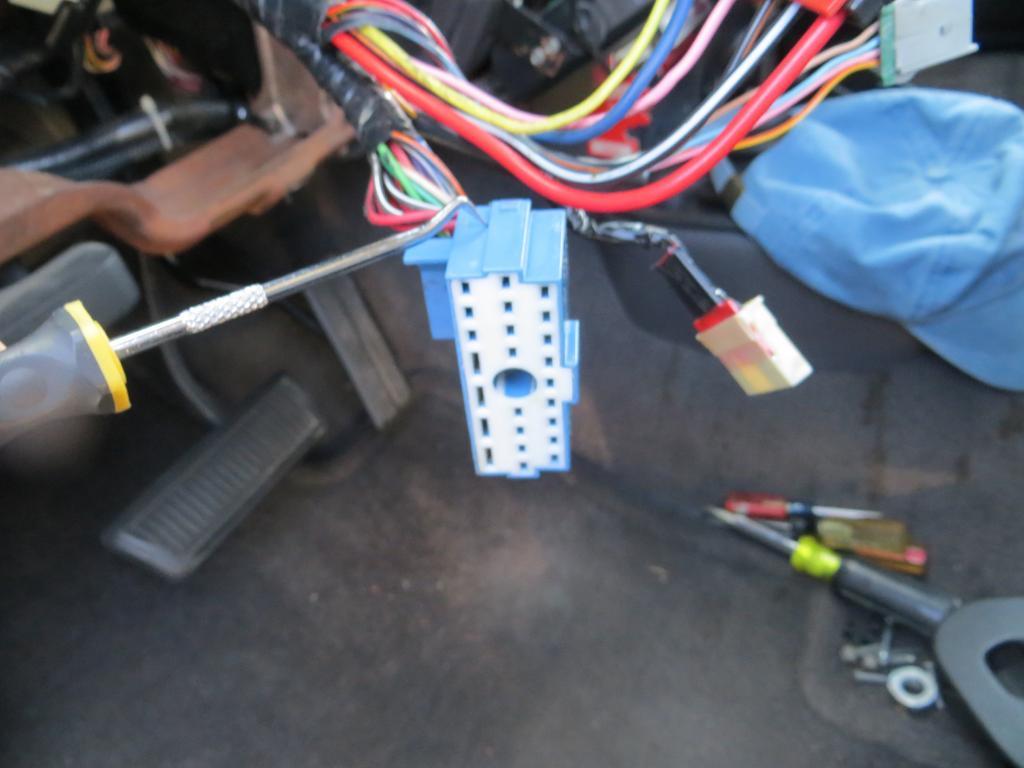

Pic2 shows plug connector/plug for switch in pic1.

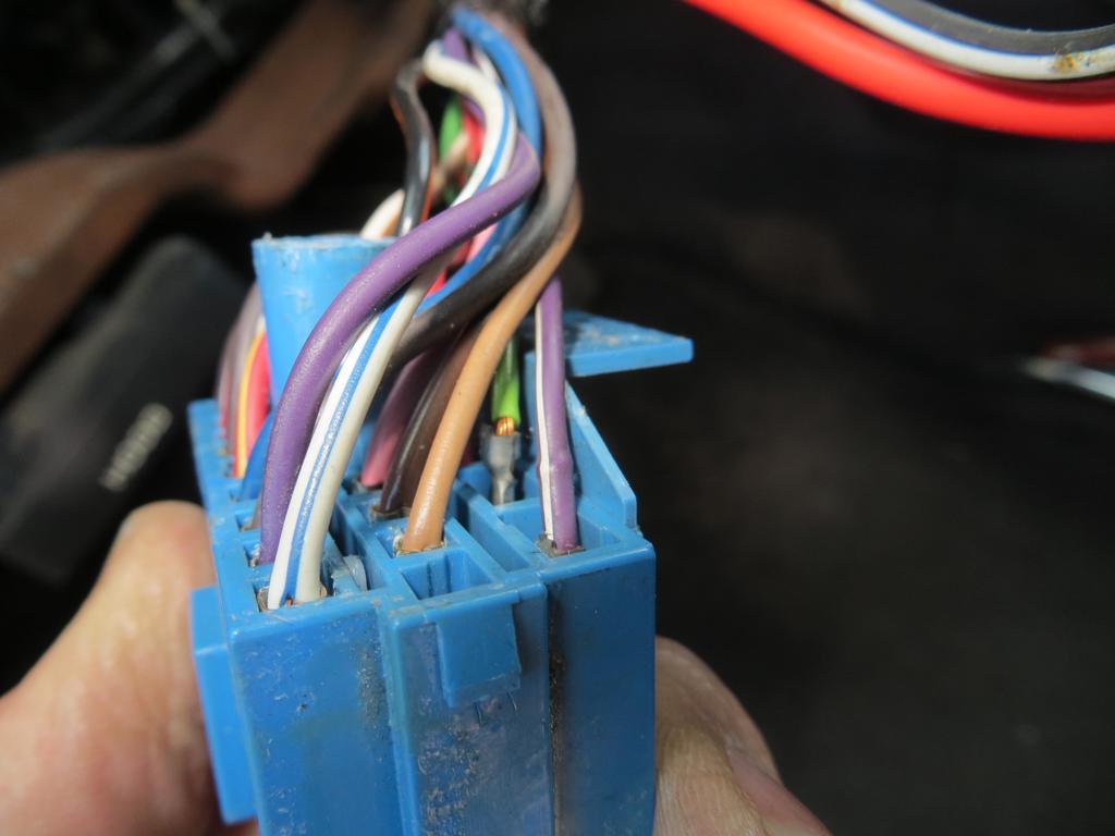

Pic3 shows green wire dislodged from back of connector/plug. The little plastic lock tab that secures the spade connector into the block was broken so it either slipped out over time or just pushed out last time I inspected and reconnected???

When I reconnected the blue connector/plug I used a dull pick to push the green wire/spade fully into the switch male blade "hopefully". I wondered if this loose wire had something (if not everything) to do with the reason "sometimes" the intermittent wipers would stall in down swing and then start again???
So, upon putting everything back together and connecting the batteries I was hopeful at least the intermittent wiper stall would be resolved. To my surprise when I started the truck up and pushed the cruise on button it actually came on! "And" all the radio controls worked like a charm! Whoo Hooo! I went for a ride, the trans seemed to shift normally too, or was it just my imagination? I stopped for a coffee and let the truck run (without turning off the cruise). To my surprise when I came back to the truck the cruise light was still on. Before if I left the cruise on when parked when I returned it would be off and I'd have to shutdown and restart to try to get the cruise back on, sometimes it would work after a restart (or 2, or 5) sometimes it wouldn't. I tried all the radio controls, which still worked too. I headed down the road with everything working like a charm for a good test drive. About an hour later as I was heading for a celebratory adult beverage, listening to a CD, the CD seemed to skip (which was odd as it was a fairly new one) and when I looked over at the radio I noticed the cassette player was starting to play and then I was listening to whatever was on the cassette. I thought that's odd and pushed the CD button to resume. As I parked at the adult beverage getting place I tried the radio controls "NOTHING" WTF!!! I turned the cruise off and then on and it held??? After 2 beers I decided to head home. Started the truck up, pushed the cruise button on = it came on, tried the radio buttons = nothing. I pulled out of the lot, drove about 100' to the light and noticed the cruise light was off, of course it wouldn't come back on.
My fix was short lived = bummer. Tomorrow (weather permitting) I'll remove the column covers and see if the green wire slipped out? BTW: What the heck does the wiper etc. switch wiring have to do with the cruise/radio controls???? I guess all the wiring is somehow going to and/or from the CTM, ECM, PCM etc.
