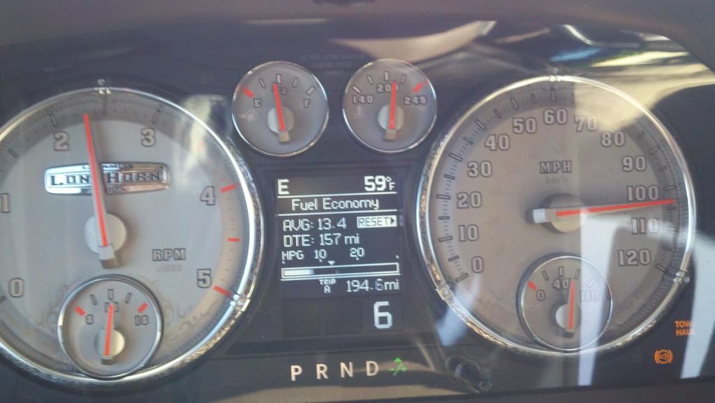

Your new truck will not even have a "muffler" since the EPA stuff does a fine job of that already. My son added a 5" back pipe to his 15 3500 Limited and it gave it a really nice throaty sound but I really doubt it made a bit of difference in performance.
Really a nice ride at 103! 2011 RAM Dually with 3:42's.
