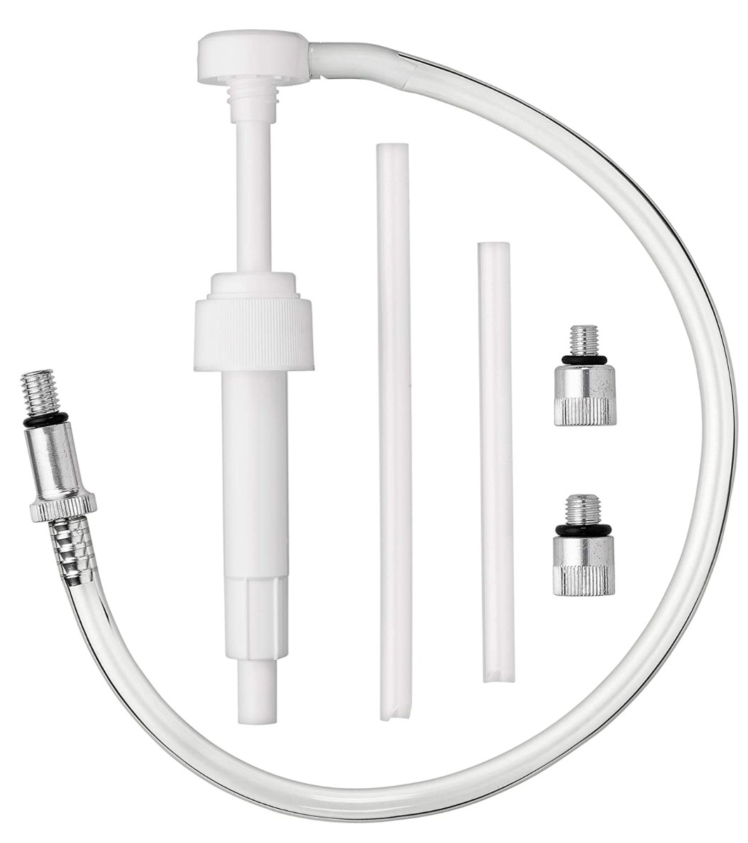

Are the cover holes on the NV5600 all the way through like they are on the NV4500? I always filled through the upper hole in the PTO cover on my NV4500. Matter of fact, I used a pump meant for filling the lower unit on an outboard motor. The adapter on the end of the hose screwed right into the cover bolt holes.
According to this post, yes you can fill the transmission via top bolt of PTO cover.
