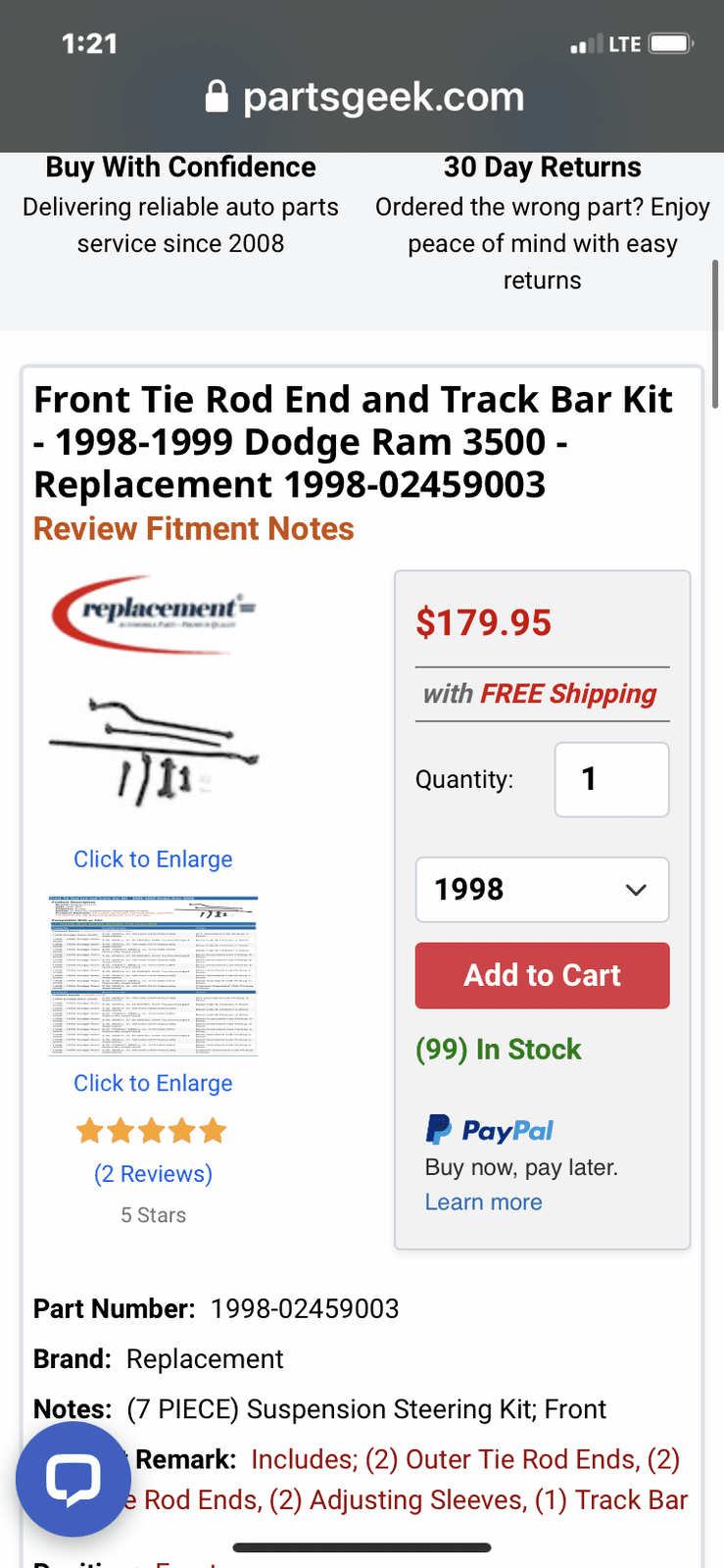

i’m in need of one outer tie rod end napa wants twice as much for one as this hole kit with everything included is the cheap tie rod end a bad idea?
https://www.partsgeek.com/642mf8r-dodge-ram-3500-tie-rod-end-and-track-bar-kit.html
Which tie rod assembly do you have? Y style (light duty) or T style (heavy duty), 98-99 used both. Yes, Napa is high.

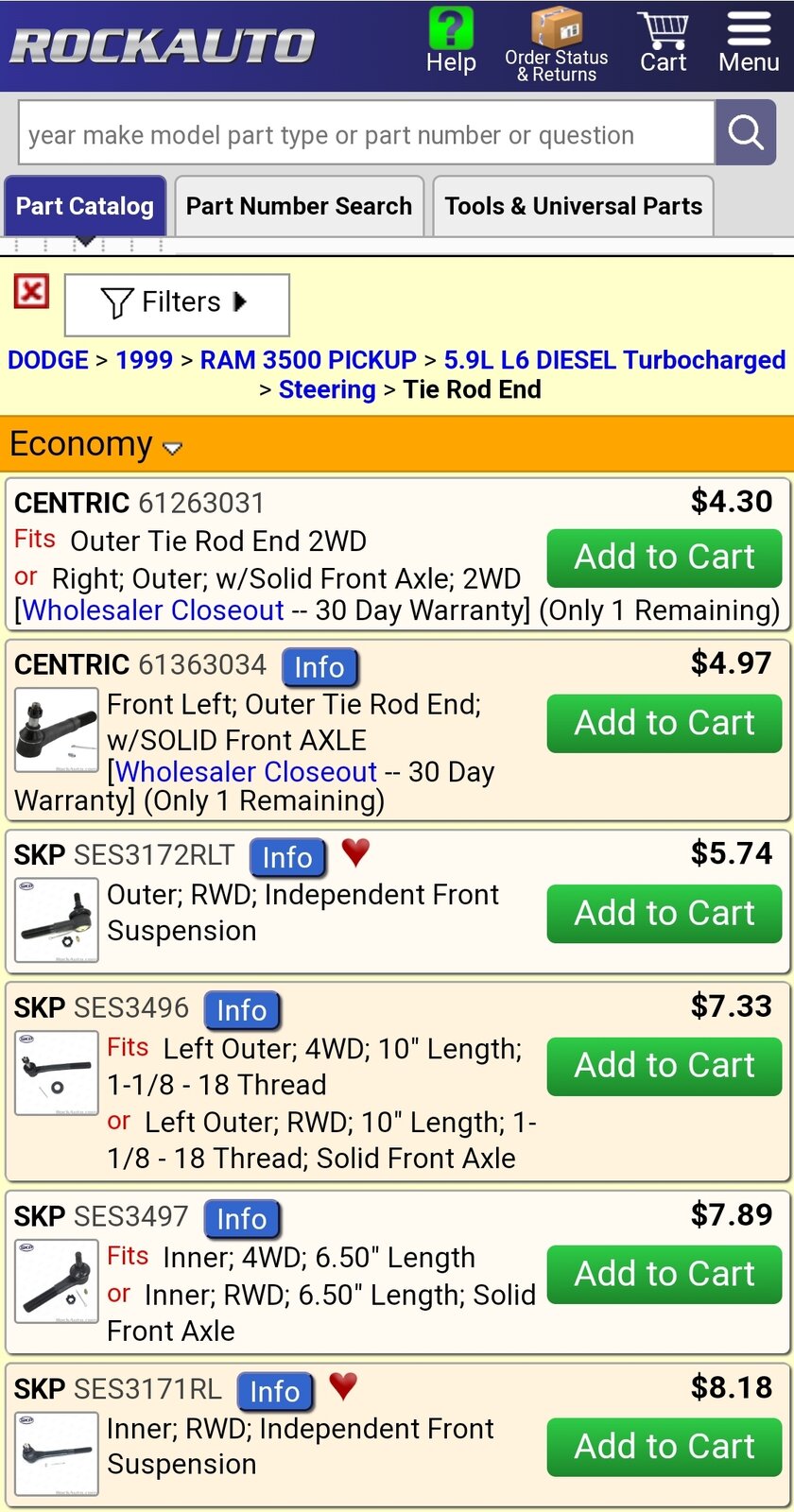

Odd are you sure you got the NAPA number correct, RockAuto is still only $25 for their high end stuff.
Looks like there are some closeout items listed for RockAuto, plus there will be shipping, but there are RockAuto codes posted pretty regularly.
Here is their low end for a '99
https://www.rockauto.com/en/catalog...urbocharged,1377581,steering,tie+rod+end,7428

I wouldn't buy any tie rod end at any price that doesn't come with a grease fitting. In this climate, the boots dry up and come off. Even after that happens, it's possible to pump in more grease regularly until the part itself is too lose to continue using.
Admission: I didn't look up any of the parts in the illustration to find out if they had grease fittings.
Edit: Looking again at the illustration, it appears that there are grease fittings, even with the five buck parts.

I will admit I'm not purposely running a $4.30 Tie Rod. If that's what the factory uses great, but losing a steering off a few bucks would be tragic.
At the same time $$$ does not equal quality with these places either. The $4.30 is listed as Wholesale close out what ever that means discount wise.
