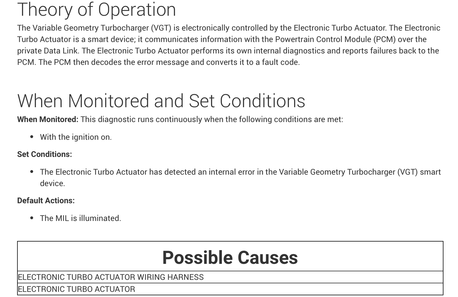

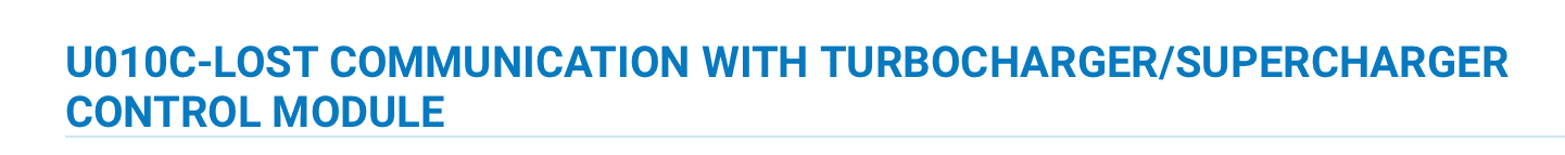

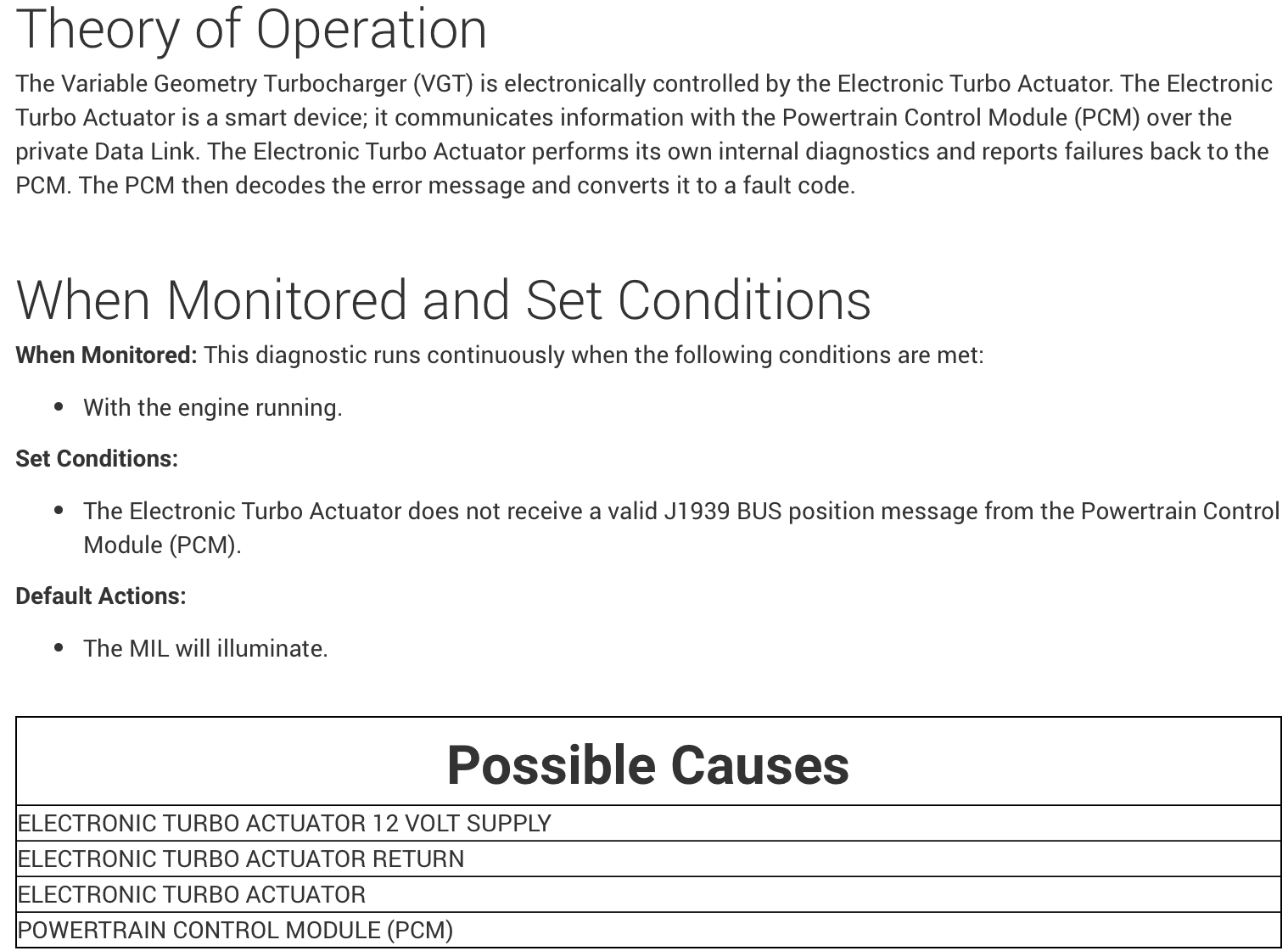

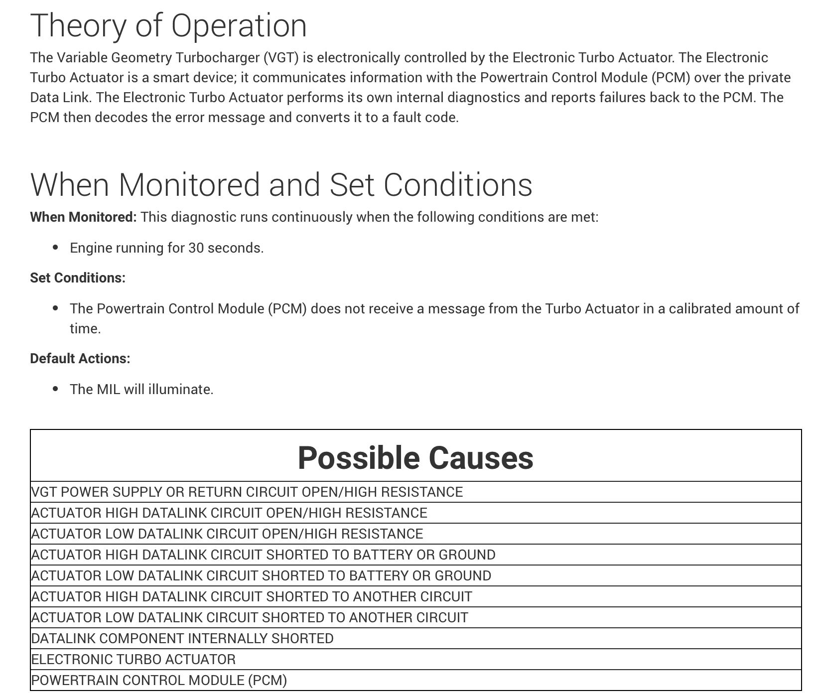

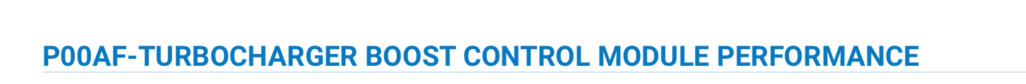

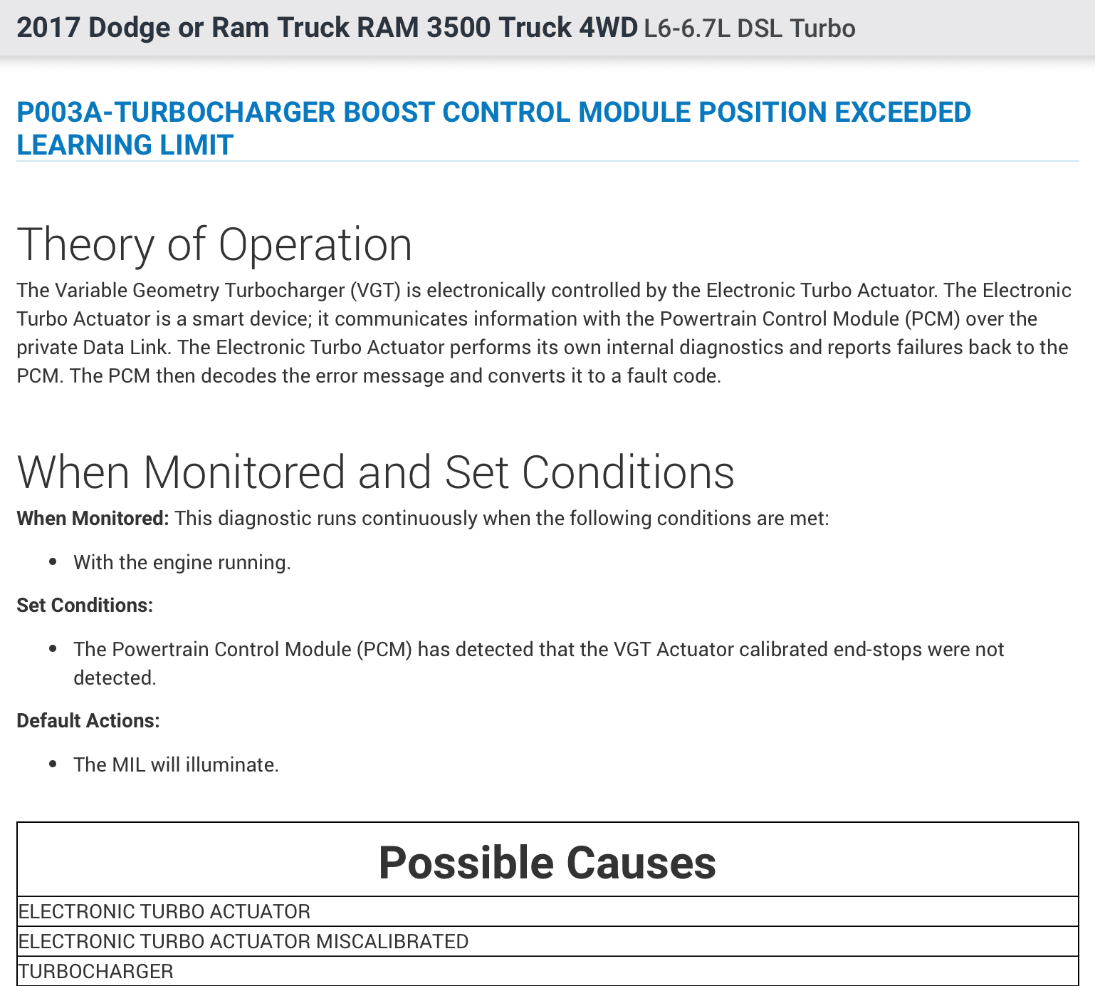

Looks like you have a VGT Actuator issue. I can tell you what the codes are but someone more knowledgeable can help from here.
Th
@cricha, How many hours on the truck? Have you been loosing boost and EB? Those are the same same codes that I dealt with from failing turbo actuator. You can reset them a few times to regain boost and EB but will be a time that you'll not have them. Try clearing them and see how long it take them to return. If your 4K hours and above, you're on borrowed time as mine failed between 4K and 5K. If it's a lot less then 4K hours, could just be a glitch and disconnecting the batteries for a reset could fix. If things come back and other issues, the actuator through Genos is the way to go!
2800 hrs on engine. I can reset the codes with the edge cts. Have reset twice. EB doesn’t seem to be working, cts shows boost up to 22#.boost varies with gear and pedal position
@cricha, I'd keep an eye on it for sure! All 3 codes came and went when I was dealing with my actuator failing. Anything is possible with the turbo actuator combo. You could have a coolant leak in the actuator cause the electronics to be failing. If you've lost EB, that's tell tale sign of the vanes not moving. On start up, do you hear the turbo vanes going through self check? If you run to long without the vanes moving, there is a risk of them becoming stuck and then needing a whole turbo setup! Big $$$! Actuator isn't a horrible thing to replace. You'll have to drain coolant, fight getting to one of the bolts behind the shock tower. There's a trick to that one, line up a 1/8 drill bit through tower, if on target, then enlarge to get bit through to socket head bolt. I had to do mine just before this past Christmas when it wasn't to warm since I have no garage to work in. The City Diesel units are the way to go, plug and play! Standing by to help. :cool:

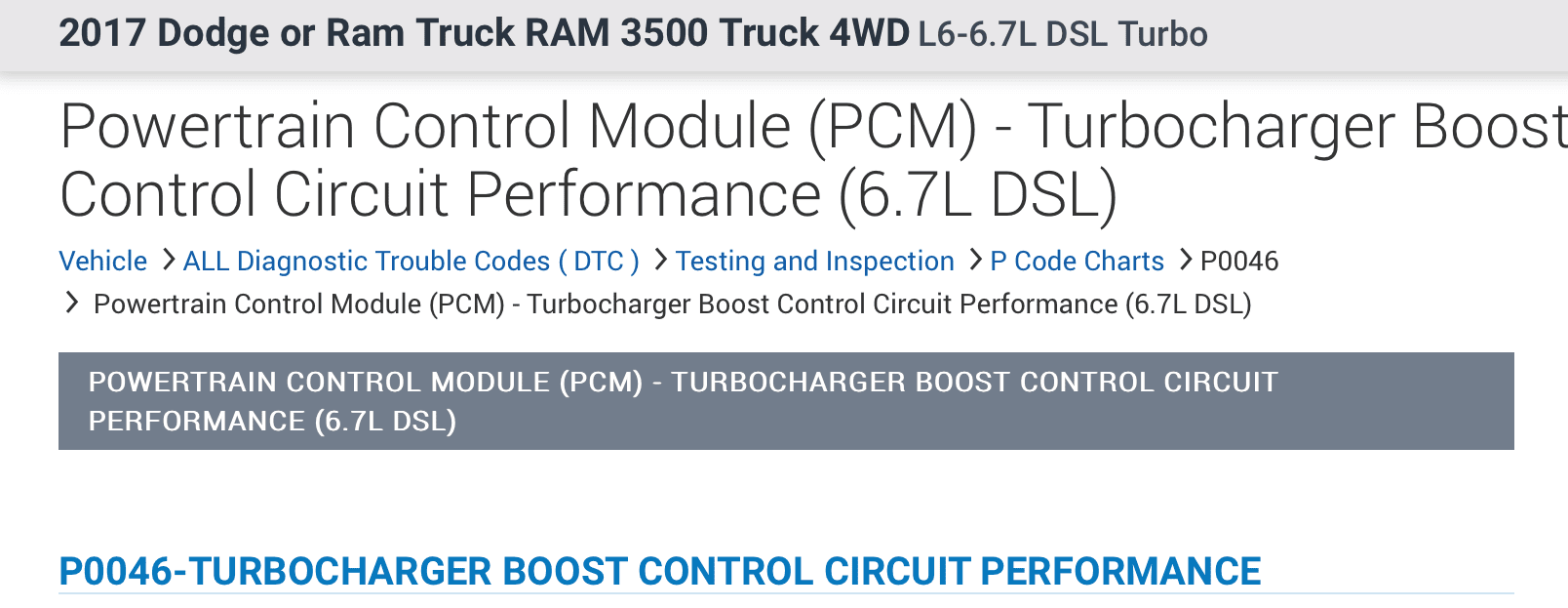

These code explanations are very helpful. After watching the install vid from city diesel, they listed one other code P0046. If you could post that info page, I would greatly appreciate it! Another comment that was made on the vid was that if the only codes that were thrown were P003A and P00AF, then it’s probably the actuator. If codes U010C and P0046 show up there very well could be other issues and a diagnostic check is recommended before buying parts.
After watching the vid, I would have no problem doing the install with the proper tools I have at home. Not going to happen where I am located currently. So I’m back to looking for a shop that can do the diagnostics…really appreciate all the replies so far!
U010C and P0046 can be caused by leaking coolant into the actuator and the electronics are failing. You'll need to confirm that the turbo vanes are moving and not bound up from excess carbon or damage. Do you hear the actuator cycling when you wait to start? if you hear this, then the vanes are able to move and there isn't a turbo issue.
