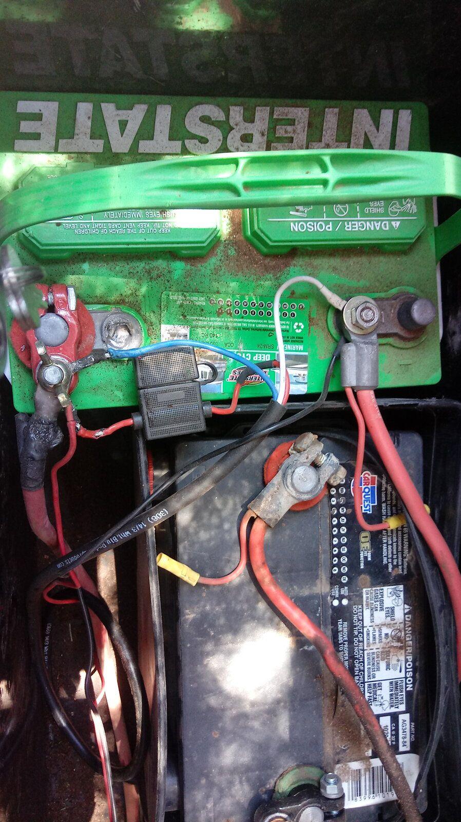

This is one of the batteries out of my Fox Mountain 5th wheel, built by Northwood. A lot of Northwood products have metal frames for their batteries, so if yours are stacked you might want to give then a look see. The 40 amp battery fuse in the camper saved the wiring in the RV, the 40 amp fuse under the hood saved my truck. Only dumb luck kept the battery from exploding.

Roger that. Just replaced dealer delivery (2) group 24 batteries with Group 31. Group 31 is the largest footprint 12 clot battery that will fit in those trays. I considered 6v Trojans, but the height gave little vertical clearance on the battery stack.
And yes, you gotta make sure the cables are routed with clearance.
The front of the battery bay has positive and negative bus connections. Really sloppily done at the factory. I’ve found a lot of shoddy assembly on my 235RLS. Disappointing.
It appears that it didn't only melt the post out of that battery, it also ruined the other. The red plastic cap on the unused post is melted to it. Also, the drive from Grants, NM to here which included an overnight stop with hook-ups didn't charge it. I have it on a charger in "repair" mode but I don't hold out much hope.
Good point. I check mine monthly while checking water level. Mine stay plugged in all the time in my shop.
Cheers, Ron
I don't have any batteries that require checking the water, but I'll include battery checks into my daily trip insp.

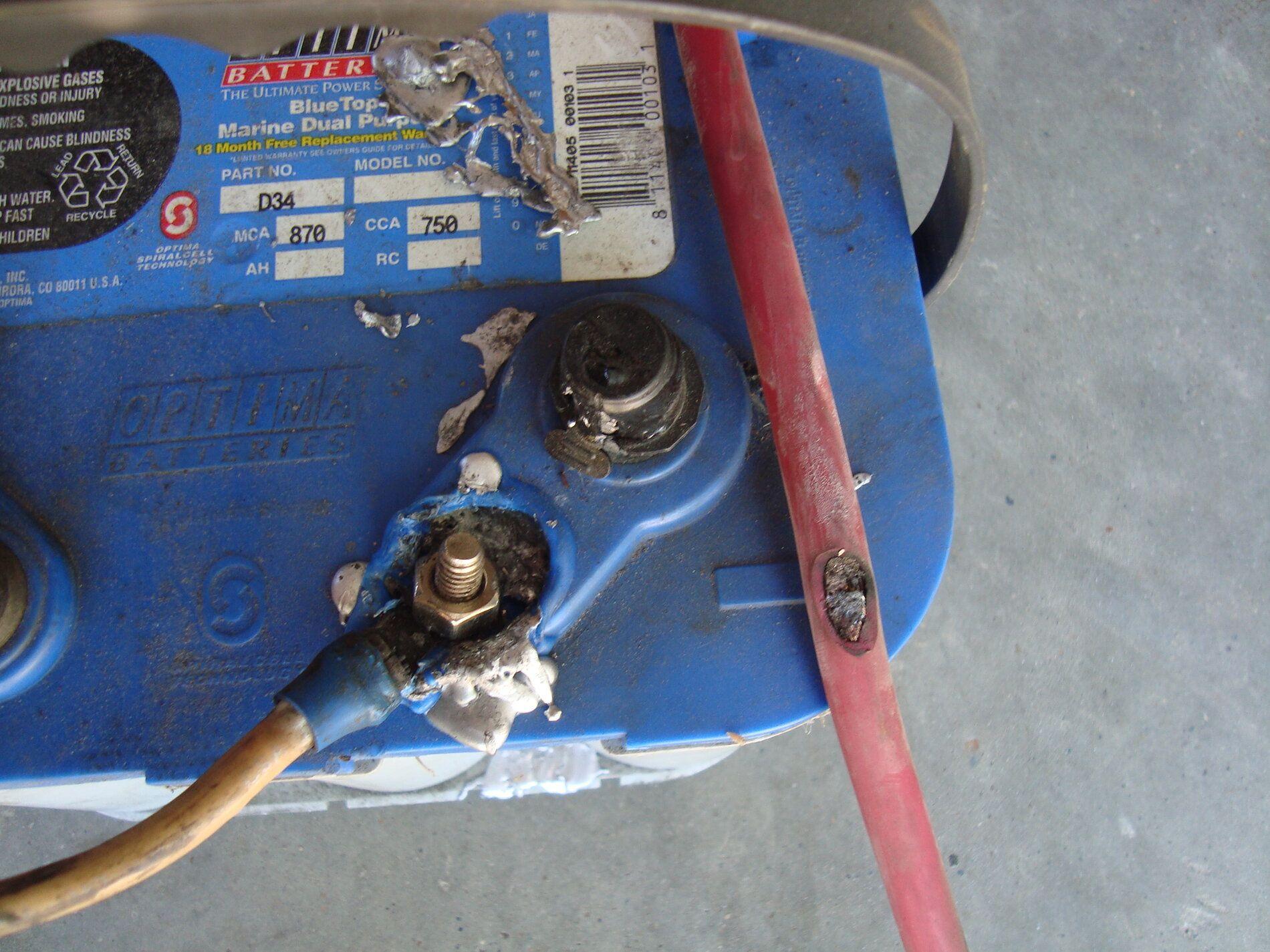

Very similar to what happened to my dump trailer. The nut was only on the stud a few threads so it arced until it finally melted the stud clear off the battery. The heat generated, even melted some of the insulation on the small adjoining wires. I was blaming the controller for the intermittent operation....the battery was okay so I used a post-stud adapter, then added a second battery.
I measured the voltage on the undamaged post and it was nearly 12, the melted one was about 7. I don't know if I'm comfortable with plugging the hole from the melted stud removal and using the battery.

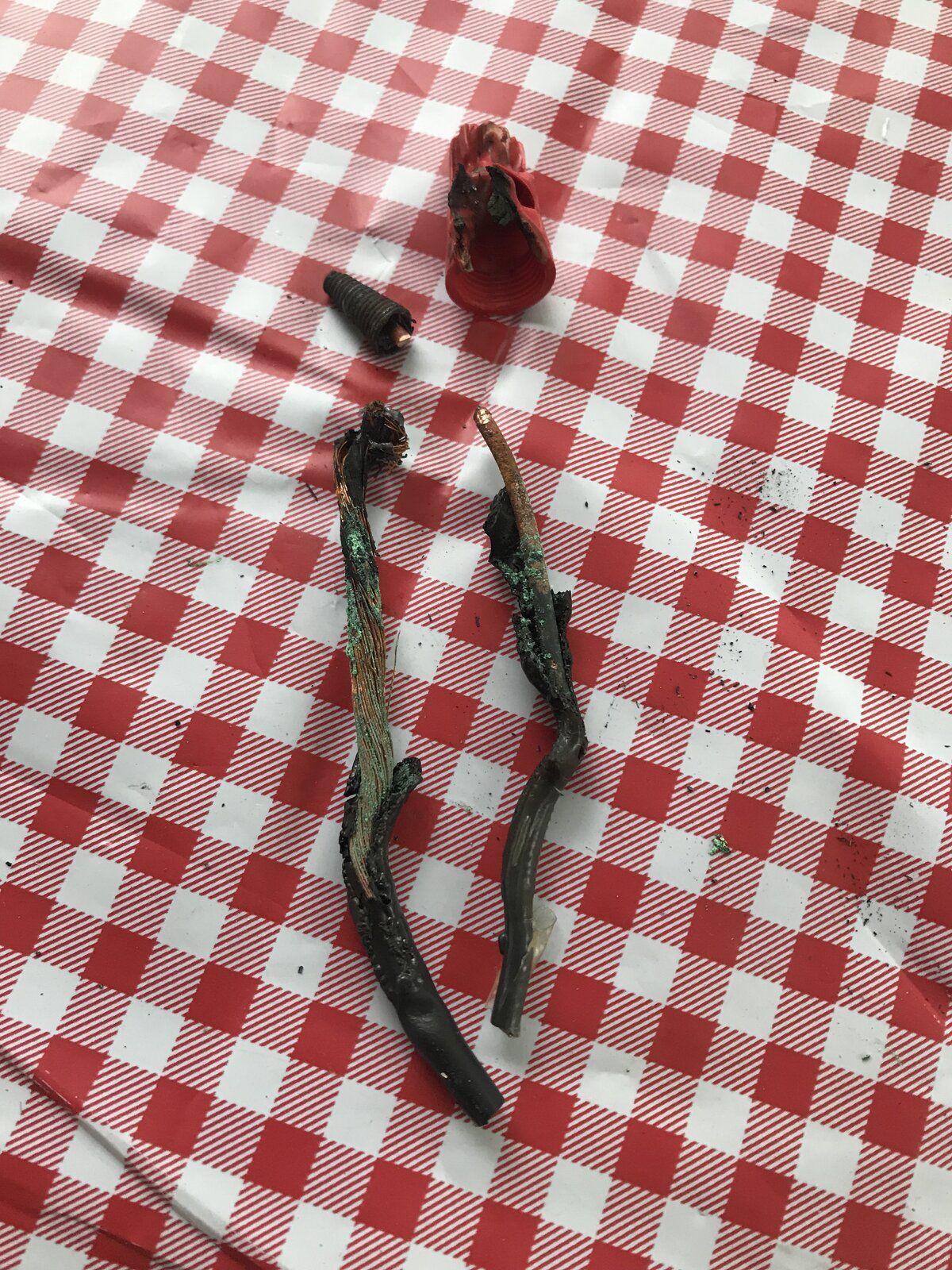

I know MWilson had a bad electrical malfunction at the Cummins rally over the weekend.
My electrical malfunction was on the 120 volt side, loose / bad connection in the junction box where the cord connects to the hardwiring of the trailer. Loose wire nut right from day one I would say....
Made enough heat finally to ground the black wire out against the steel junction box when the insulation melted off...not good..
These laid on the picnic table overnight, so they were not green when in the junction box..
