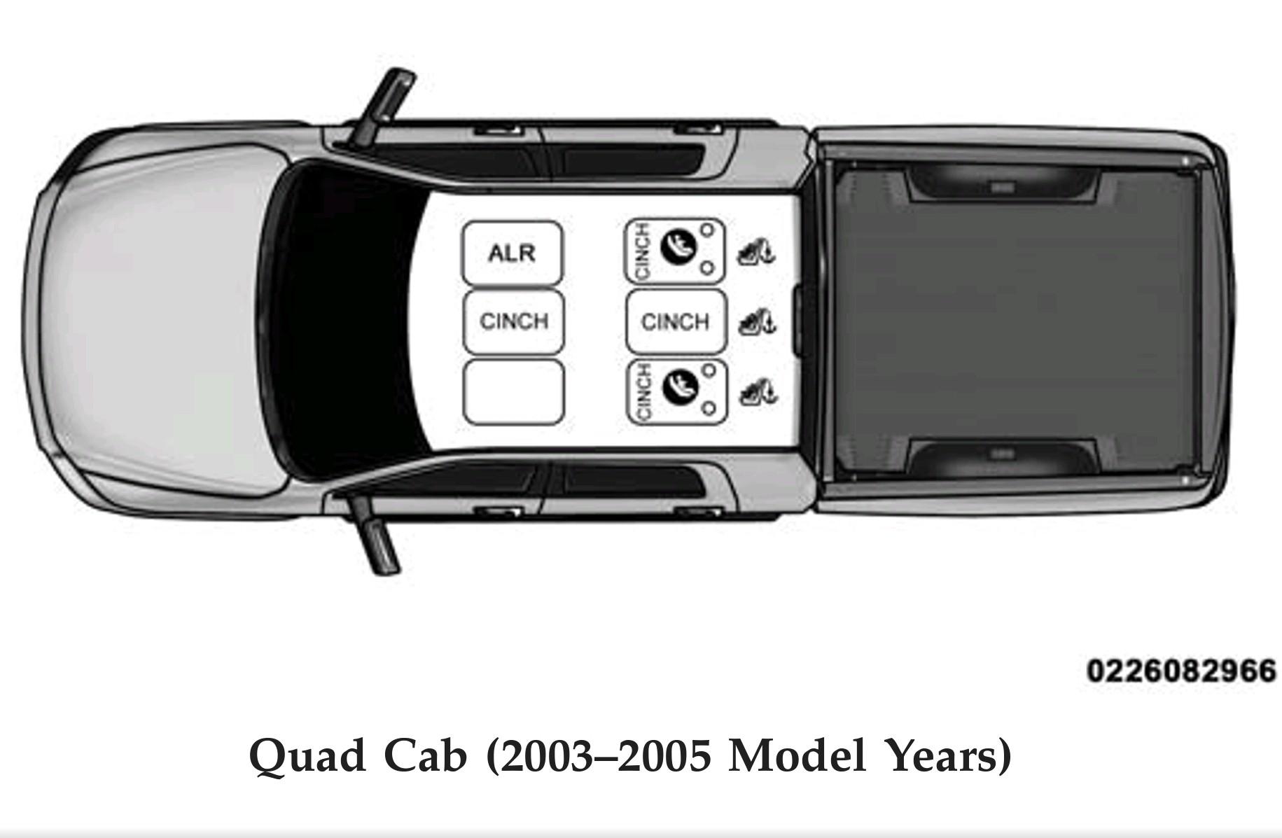

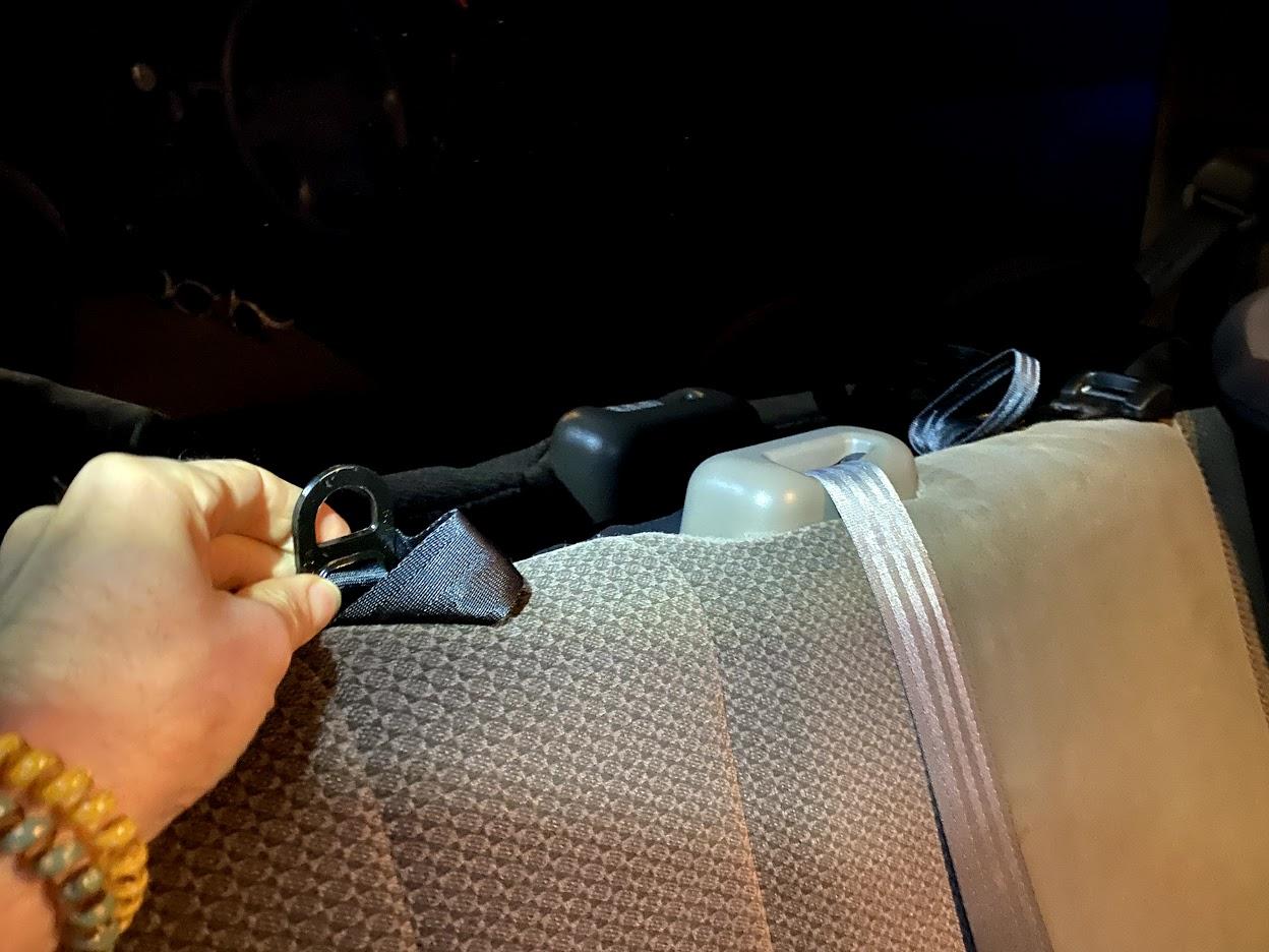

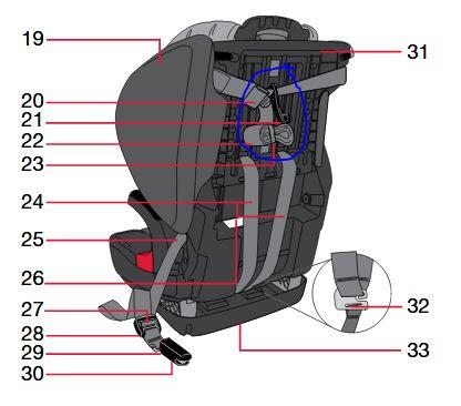

Is anyone else using forward facing child seats in the back of a Quad Cab which need the center tether attachment (see Illustration 1 below, tether is circled in blue)? Our 2003 Ram 3500 has a place at the top of the back seat for attaching something but no attachment point at the bottom, where it should be (Photo 1 below shows the attachment point in question). There is no point in attaching the car seat's center tether to the attachment point shown in Photo 1 because it is too close to the car seat (the tether is a minimum of approximately 6" long, so the tether can't be tightened). I don't know what the attachment point is intended for in Photo 1 since I haven't been able to make it work for the center tether. We don't have this problem in our 2000 Honda Accord, our 2008 GMC Yukon XL or my parents' Jeep Grand Cherokee. Am I missing something?

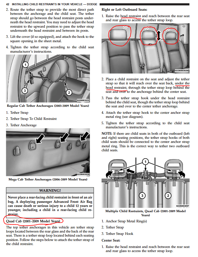

Thank you...that PDF sure helps.
Our truck does not have headrests. The instructions say to route the tether strap under the headrest, which makes sense. But no headrests...??? I will look through the PDF again in case I missed something.

If you are using the center seating location for your child seat, simply route the top tether through the center nylon loop and then run it over to one of the metal mounting loops at an outboard seating position behind the headrest. I have it mounted that way in mine and it gives you plenty of length to tighten that tether.

I have a 2003 quad cab. I have had forward facing seats in it with all of my grand kids. (the youngest is a senior in high school) I have had all three seats in once when I took he, his sister and his cousin for a camping trip in our trailer. As I remember the main thing was getting the chair hooked to the ring in the middle of each seat. I use the ring (it is actually square) today for the harness for my Lab. I don't remember it being necessary to hook to anything else. The seat belts in the rear do have cinching latch plates in addition to the clip. Cinching latch plates are no longer required in the back seat because of the clip system, but the 2003 has it.

Thank you, jgillott. That is exactly what I was missing or not seeing. It is amazing how I went so long not understanding this, then one day, bam, there it is.
