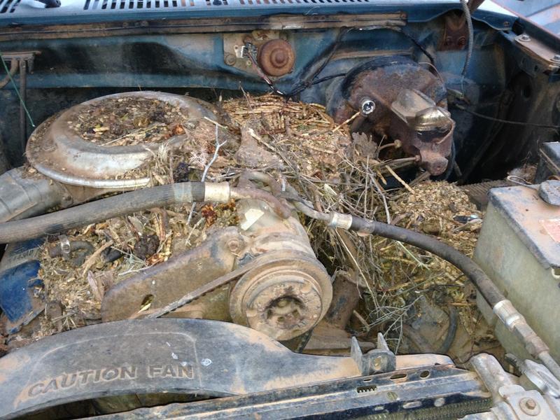

I had a pair of big pack rats attack my '95 Furd one night... I parked it about 10:30 right in front of the yard, hit the door, grabbed some chile, and fell on the couch.... I got up around 6 the next morn, got me a protein bar and hit the door to go back to plowing. Furd started ok, but as soon as I hit pavement, it had NO power... which says a lot, as it really didn't have any power to begin with!! I noticed it smoking a little as an oilfield truck ran up behind me, so I knew something was up. It wasn't light yet, so I went on ahead, about 15 miles to my other place where I was plowing. I serviced my tractor, and it was light at this point, so I pulled the hood on the Furd, and couldn't see anything..... There was some corn up on the radiator support, though... Odd..... some more down in the air intake.... pulled the air filter, and it was packed COMPLETELY full of corn, dogfood, and a little insulation from the hood.... Not even a full 8 hours!! Dirty boogers..... I've seen them completely pack an engine compartment....
This '82 Ford had been sitting almost two years....
