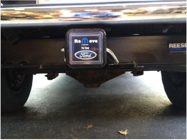

I just did the Reese Titan V which requires removing 6 of the 8 bed bolts to raise the bed in order to remove the factory hitch. Removing the bed bolts and jacking up the bed only adds 30 min to the project at most. The problem with the Curtis mfg hitch is that it will require you to buy new drawbars as the hitch height changes, the Reese Titan centerline is at the same height +- 1/2" as the factory hitch. Shop around, I found mine online (ecustomhitch.com) for $336. Here is a picture of the height and my "special" hitch cover, my bro owns one of those other brand names, gotta poke at every chance!!

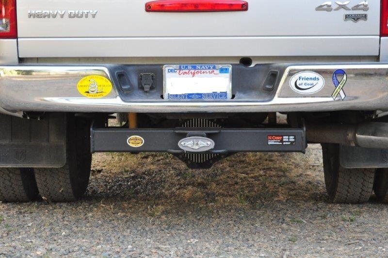

I removed my OEM hitch and installed a Reese 45299, class V hitch. It's rated for 18K lbs towing, and up to 2500 TW with a WDH. It is a 2 1/2" receiver, but you can have a reducing sleeve welded in if your don't need it. I had that done, and it works well.
#ad
#ad
You can see here where the OEM hitch was installed. The main reason I chose this hitch is because of how it installed, everything else used too few bolts and looked sketchy at best.
