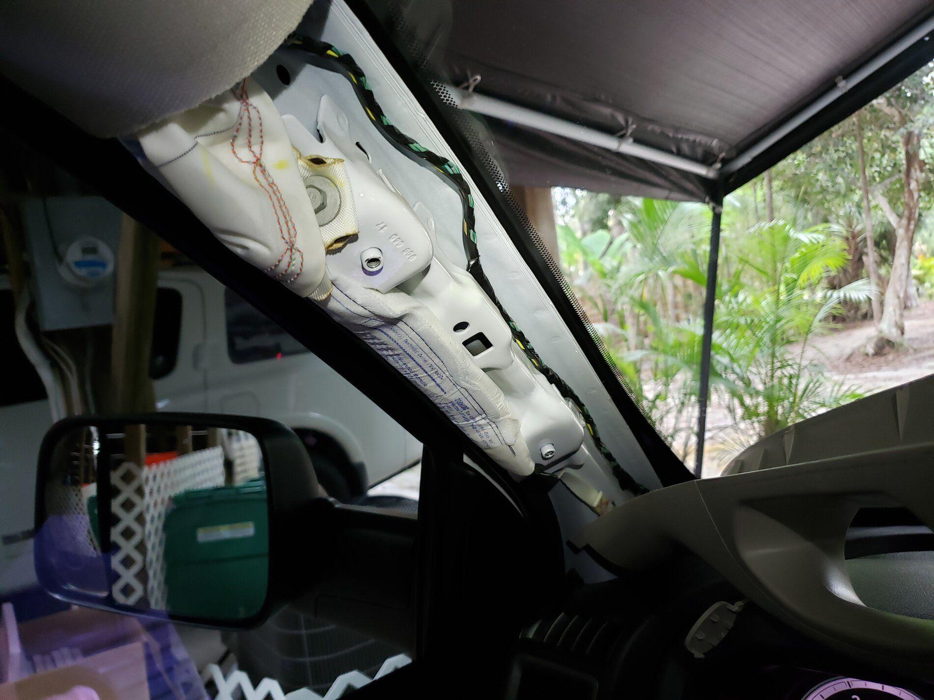

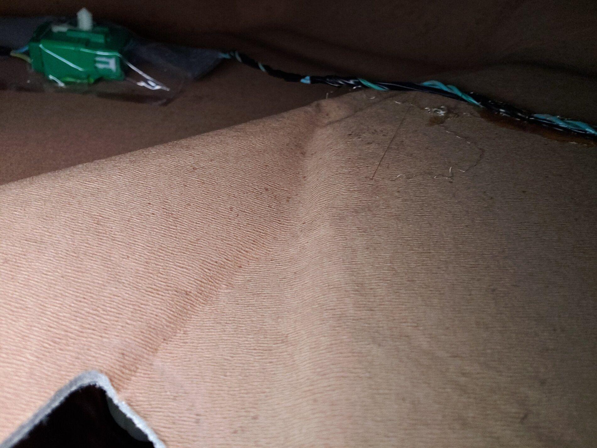

So I got here a 17 3500 6.7 tradesman, 8ft bed, not dually and I'm wanting to add the cab clearance lights on the roof of the cab. Anyone done this? I have to layout and drill and seal the lights and my main question is power hook up. I'm told some models have a pre run wire harness going up the side of the windshield under the oh **** handle /trim. The drivers side is the only side which has wires running up from the dash to the headboard. The only wiring harness I see is just above the headboard in the front and the harness is already connected to something...picture attached. Do I need to splice into these wires above the headboard or should I find the wires coming from the headlight switch and use those? Videos online show the installs with trucks which already have the clearance lights harness sitting there next to the windshield.
I don't see that at all maybe bc it's a tradesman package. Anybody know where best to get power for these lights??
I added them to my '18. I've never heard of the harness by the grab handle.
I used the MOPAR kit, and those instructions have you tap into a module on the firewall. Let me tell you that it's a PITA to get to!
I used a voltmeter on the headlight switch, but nothing provided a 12V source with just the parking lights on...everything is computer controlled these day.
So, I'd suggest the MOPAR kit and just plan on the single wire splice taking 80% of the install time. I had to remove the stereo amp, and parking brake bracket to get to the proper module for the splice.

Wire harness is under passenger a pillar. Its a grey 2 wire plug near the bottom of the windshield. I used a T-tap when i installed my recon cab lights a year ago and haven't had any issues. I even made my own wire harness so that I could easily change out just 1 if I ever needed to.
