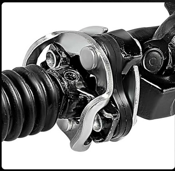

Can you explain what a rag joint is? I noticed some kind of donut in there long ago but have no idea of its composition at this point.
Thank you for the reply.
The photo below shows a close-up view of the "rag joint" reference on an OEM style steering shaft. It refers to the flexible part of the joint that dampens impulses to the steering wheel. If the flexible part is worn out, sounds or clunks could be transferred to the steering wheel.
