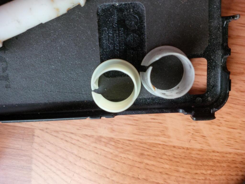

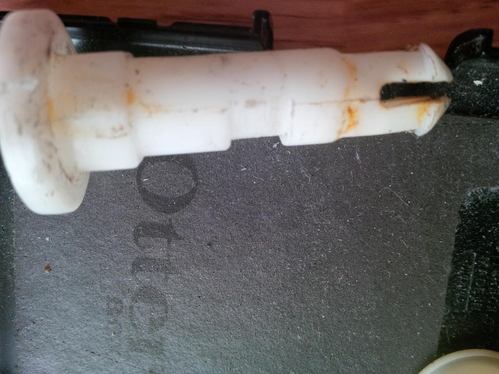

hi, recently my nv 5600 was getting growly.hard to get in gear ,stop and go was a lot of grinding.any way the pedal had a loy of back and forth and side to side play.i pulled the big white pin that goes through the actuator rod and it had a groove about 1/8 of an inch on the push side.i phoned dodge and for about 12 bucks Canadian they fixed me up with pedal pin bushings and an actuator pin/bushing.after a couple of hours I had my clutch back . as a quick fix you can pop it out the left side with a flat head screwdriver, turn the pin 1/4 or 1/2 as it fits into a hex pocket turn .do not rely on this get it fixed p.s. I a will try and post a photo of the worn pin/bushing
actuator pin at pedal
pics of parts are up. thanks for reply
