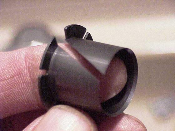

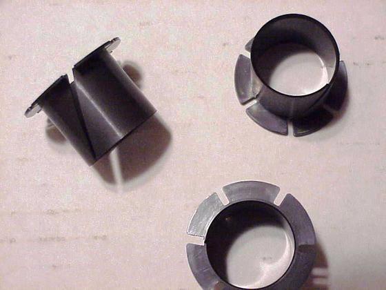

I will be getting a big bucket of these any day . I was vary reluctant about having them made.
After doing some research I learned that no one was making them in the after market. Dorman has Ford and Gm (they are too small for Dodge) They said that they did not have a source for the Dodge .
So I had them made. I chose to make them out of Delrin instead of nylon. Delrin holds up better under pressure. They will also fit all the rear wheel drive cars from the 60's threw the 80's as well. This same style of bushing was also used in the throttle pivot mounted on the engine on the Cummins trucks. I was thinking about making some of those as well.
They seem to be loose on all the trucks I see lately. What do the rest of you guys think ?

Nice! I can use a few. A few years ago, i looked high and low for those, and nearly had a couple custom made from Delrin myself, but it's extremely expensive to have just a couple made. I'm still limping along on an old one.
Delrin is pretty cool material. I made some bushings out of it for my wife's rocking chair-4 grand kids Nd 20 years still rocking
