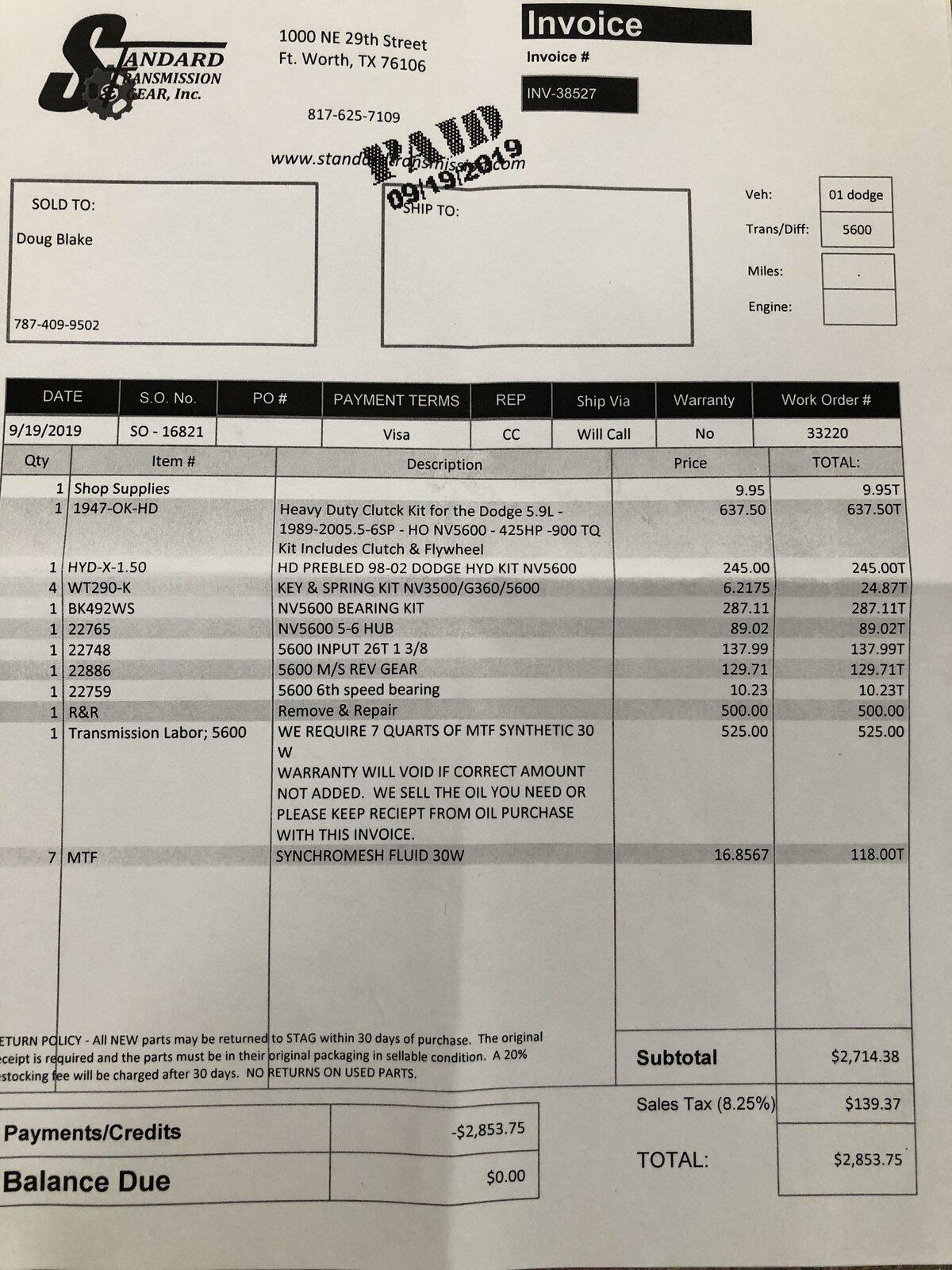

They found my input shaft bad when doing my clutch. It got pretty expensive quick.
