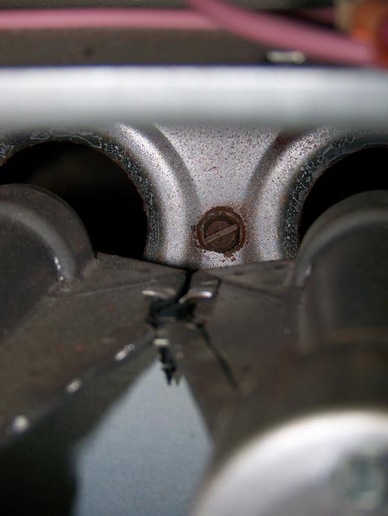

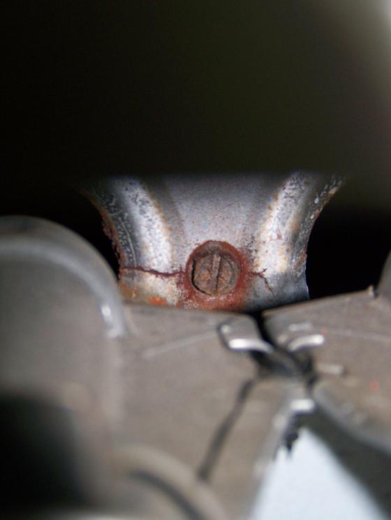

Check your Burners and heat exchangers. If you have an "inshot' style burner in your furnace?
You can see where the heat exchanger is screwed to the plenum. Look at those screw locations.
If you see a crack between the burner tubes (It can run through the screw hole), your heat exchanger is cracked.
If you are having aching muscles, low energy and cranky attitudes, that can be one indication that there are low levels of CO contaminating your heated house air. Indicating that there are cracks elsewhere. CO does not have to be in quantities that can set off your alarms. IMHO, if the CO is at high enough concentrations to set off your alarms, you better have an oxygen mask. (figuratively speaking, Its already to late as the CO has displaced oxygen in your cells)
I have a few pictures of our experience to pass on to you. Hopefully this post and the pictures will help others.
A visual inspection is something you can do when you do your furnace maintainence. If you have an older furnace, it can help to have a HVAC tech use a meter on your house air, periodically. CO measured in parts per million(PPM) is an insidious poison!

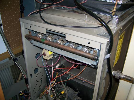

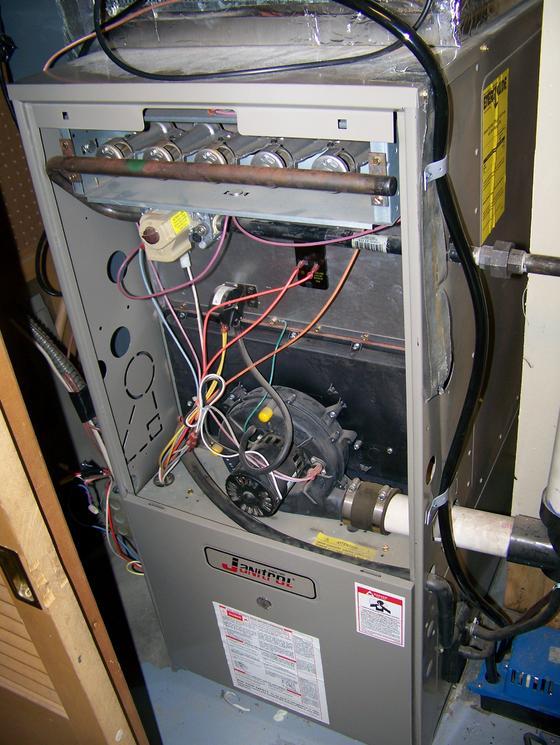

This is a name brand up draft 92% efficient furnace that is 15 years old.
The burners can be located at the top or in the middle above the blower fan.
I've see many different configurations.
The heat exchanger can be replaced. However in our case, we are going to dump this unit with an upgrade furnace
and duct work. When changing out parts, you might as well replace the vent fan(permanently lubed ) and the blower fan(also permanently lubed).
