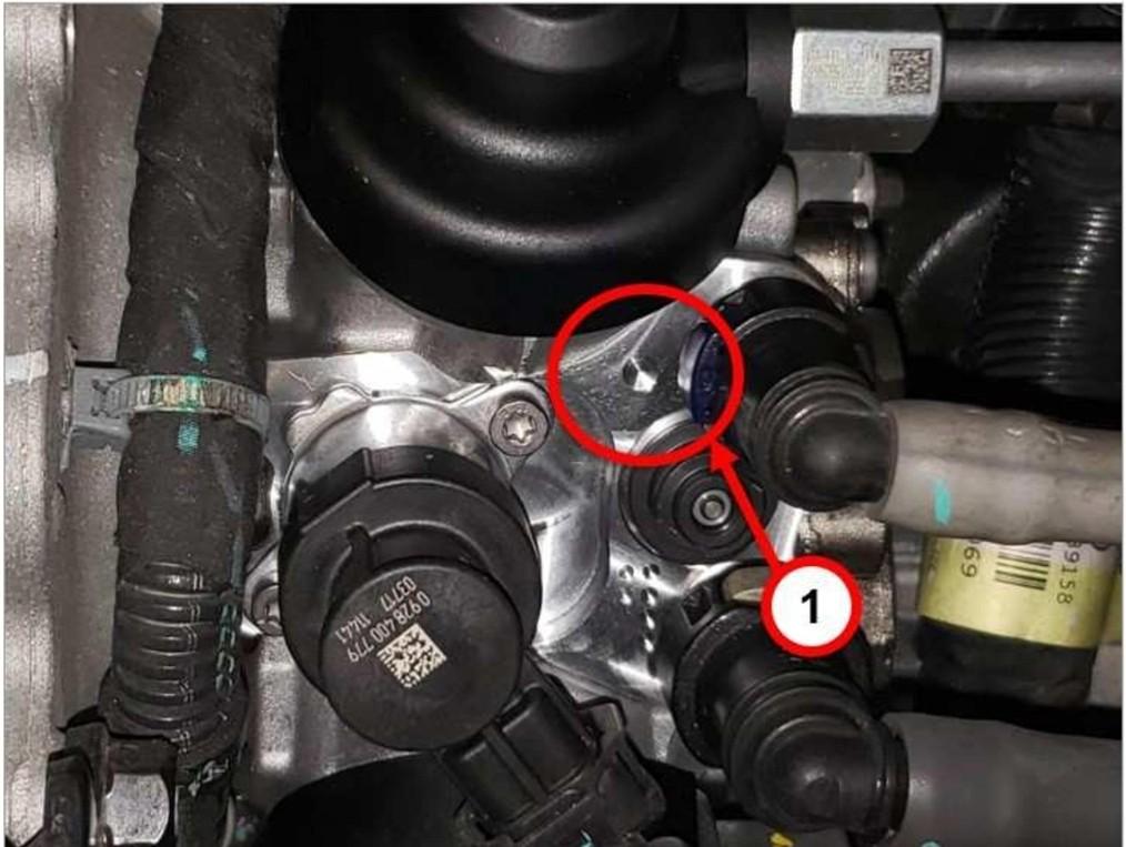

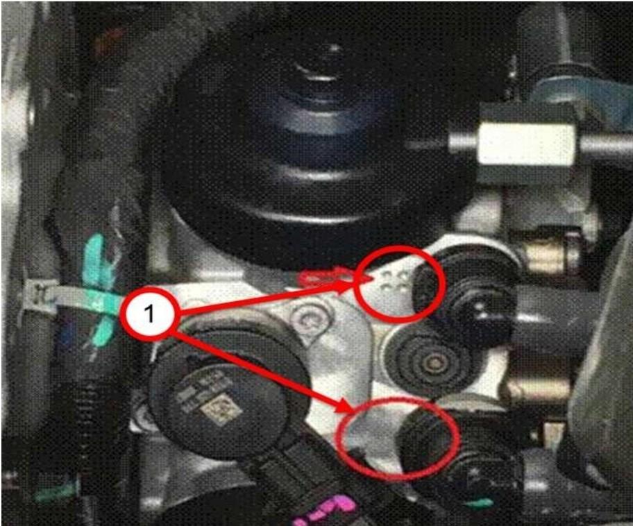

The older style Asymmetrical has 4 small machined dots on the upper right of pump, the newer Symmetrical style has a larger single machined dot on the upper right and 4 or 5 smaller machined dots on the lower right.
Moparinsiders posted these pics to tell the difference. Not that you need to tell them that, just thought it was intresting to see how to tell the difference.
New
Older

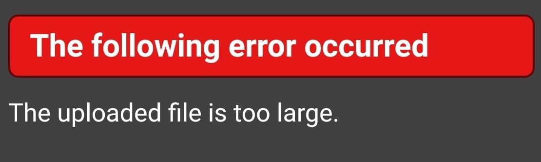

Too big to upload, but its identical pretty much to Rev A that is available all over.
