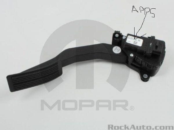

On my 2006, the APPS (Accel Pedal Position Sensor) is located on the Accel Pedal itself. Part num 53032794AB. Mine has approx 130K.
See Pic
