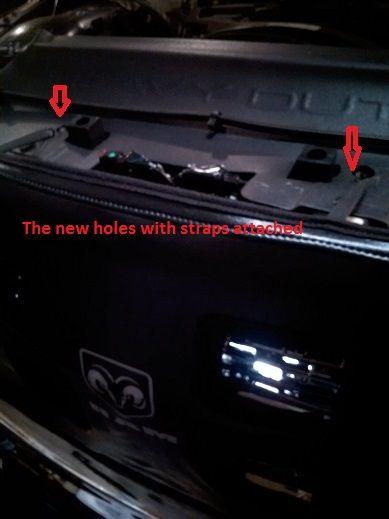

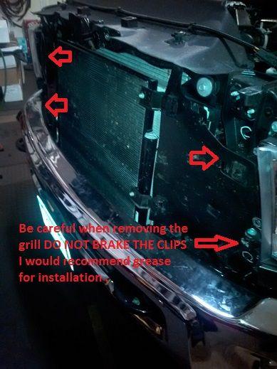

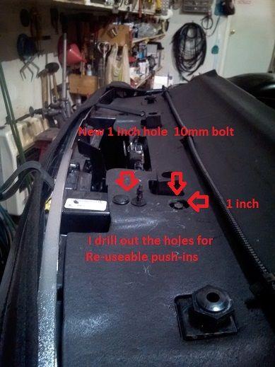

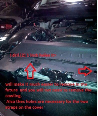

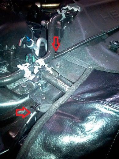

OEM WF IMO are not necessary until -0F Temps, and out right worthless at temps above 30F ,damaging at Temps above 40F on OEM setups, Maybe on deleted Engine W/O EGR.
Beside its ugly, looks like cheap China duck tape.
