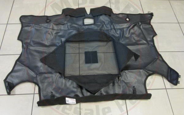

Does anyone have experience with the mopar factory winter front grill covers?
I am concerned about road grit and salt getting between the cover and the chrome causing scratches, and am considering having ppf film put on the chrome to protect it from scuffing and scratching but I’m not sure if it’s necessary or not.
Lastly, do the covers fit well or is it something that’s going to need to keep being played with and adjusted to keep in place?
Never had an issue with grit/salt causing any problems on current or past diesels. Best advice I can give is learn how to install when it's warm out (not the easiest to install) so you know what to do when it's cold. It fits fine if installed correctly.
I actually run one of these on my F150 with the 4.2l v6 to help it produce nice hot heat when it's -20F out. I leave it on till it gets in the 40-50F out.

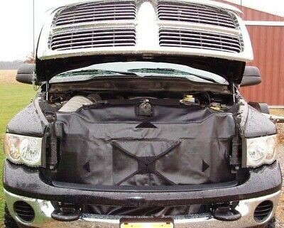

Third Gen genuine MOPAR was the right choice over aftermarket. That may still be true for later generations.
DIY or some cardboard ain’t the same.
This wraps all heat exchangers.
Off by 41F — 31F towing — monitor coolant temp as thermostat coming open means “remove” as daytime high gets above freezing.
Otherwise, adjust flaps for air to engine fan. (Grade pulls).
VVT engines don’t need much help except at highway speeds.
Have an exterior “front” for latest Freightliner. (Grille cover). No damage to plastic chrome.
Grille covers aren’t in the same league as a true winter front. See what Ma MOPAR recommended.

That is just like the one I had for my 06, loved it and it was so easy to put on

Thanks for the input. I was just wondering about the likelihood of damage because the last cover I looked at from Mopar had a pretty specific set of instructions:
Only install cover on clean dry surface (obviously)
If cover gets wet, remove and allow to dry then reinstall ??? (so every rain or snow?)
If dirty remove, wash, allow to dry and reinstall
Probably just CYOA type instructions but it kind of made me worry about causing scratches so I never picked one up.
So on my 2022 the warm front just really just clips on to the front grill it’s not really behind anything.
It just kind of tucks in the corners etc of the grill . Looks like it wouldnt stay on but it does. Easy to put on and take off warm cover warm garage. Not so good out in the cold. Really warms the truck up fast but I think I would take it off going thru the laser wash . The blow dryer might take it off. The hot Cummins and fan just suck it right into place and it stays. Alaska now is on winter fuel 50 per cent #1 50 percent #2 diesel. With warm front and Amsoil All in One in the fuel my fuel mileage has increased about 2 miles per gallon.Real hot engine burns less fuel. I guess ?

The latest FTL is the same. Perforated sheet of vinyl (cutouts). Warning from Minnesota headquartered fleet is DO NOT USE above freezing. Loaded, deadhead, bobtail. Period.
Latest engines do the work needed quite well. So it’s not much needed to cure cold blast.
