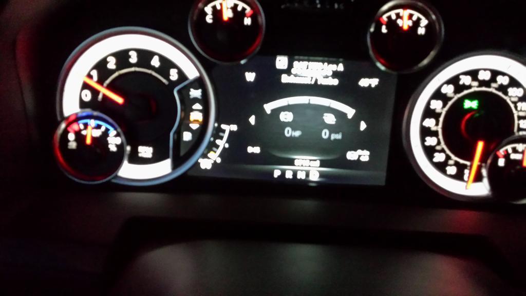

Given where I live.....and never see cold weather, I am completely uninformed.....:confused: Finally, we had a cold morning, down to the low 40's (don't laugh) Truck fired right up and didn't even notice if the grid heaters went off, there was no wait to start delay(keyless ignition). A minute down the road, the evic showed the little heater symbol lower left corner( sorry, crappy picture) and it stayed on for my 15 minute ride to work. Truck was up to temperature.....This seems wrong, I assume the heater is for start up only?

I believe that maybe the indicator for the DEF heater but it is only a guess.
That may be......I knew the def tank had a heater but don't know if it shows a gauge/light when it is on. It was only around 45 degrees, didn't think that is cold enough for a heater to run.....:confused:
Sam
Mine only stays on for 6-9 seconds when it is cold and then off. That little guage actually keeps a count down time until the heaters kick off. It has never stayed there for 15 minutes and my truck has seen many sub zero starts last year.
Thanks for the info......that makes sense. I'm surprised that at down in the 40 degree area, the grid heaters aren't on in the first place when I start it, let alone be on that long.......more problems....GRRRR...

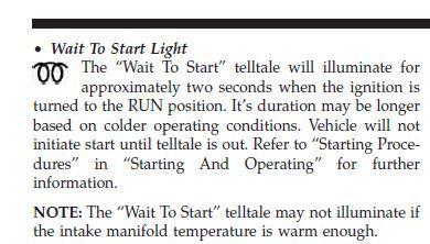

hard to see but it looks like the icon for the intake heaters. Mine acts this way: push the ignition button to run, and it sits there for 2-8 seconds depending on how cold it is, it goes off, then the truck fires up. The icon goes off before it starts and stays off. I have never seen it come on while driving, ever. I have also never seen anything in the manuals indicating that there is an icon for when the def heater is on. Maybe you need a software update or have an issue? better get it checked out.

I think it works this way. I have keyless start by the way. If its cold enough, I get, in sequence after pushing the start button, words stating the truck is preheating and will start when preheat is complete with the wait to start curly cue icon. If wait to start lasts long enough that the EVIC message disappers, then I see the timer "icon" in the lower left display as you have it your first picture. If the preheat times out before this message disapears the truck starts and I never see the timer icon at all. There is no mention or explanation of the timer icon in my 2013 owners manual or diesel supplement. Ken Irwin

Anyways, I don't think the light should have stayed on during your drive that day if it does indeed designate grid heater operation.
If I saw it happen again I would be asking some questions. The third gens will even kill the grid heater cycle above a certain speed if you take off quickly in the cold.
