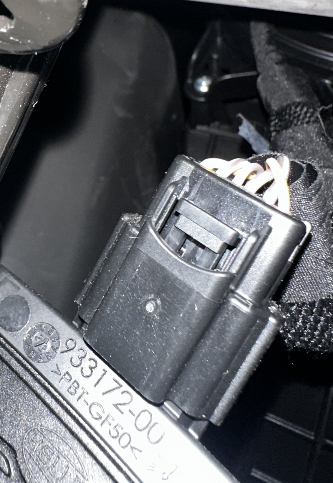

Question- I need to disconnect and reconnect this a few times most likely. .. However I do not want to break it.. I have had limited success in the past not breaking.. If i understand correctly the tab in the middle would pull up and then it should come apart?
Thanks....
I believe that it's a "push tab" and wiggle to come off. If it was a lift tab, there would be a bit of a ramp showing with a lock tab at the top of the connector. Just remember to wiggle the connector as you pull it out.
