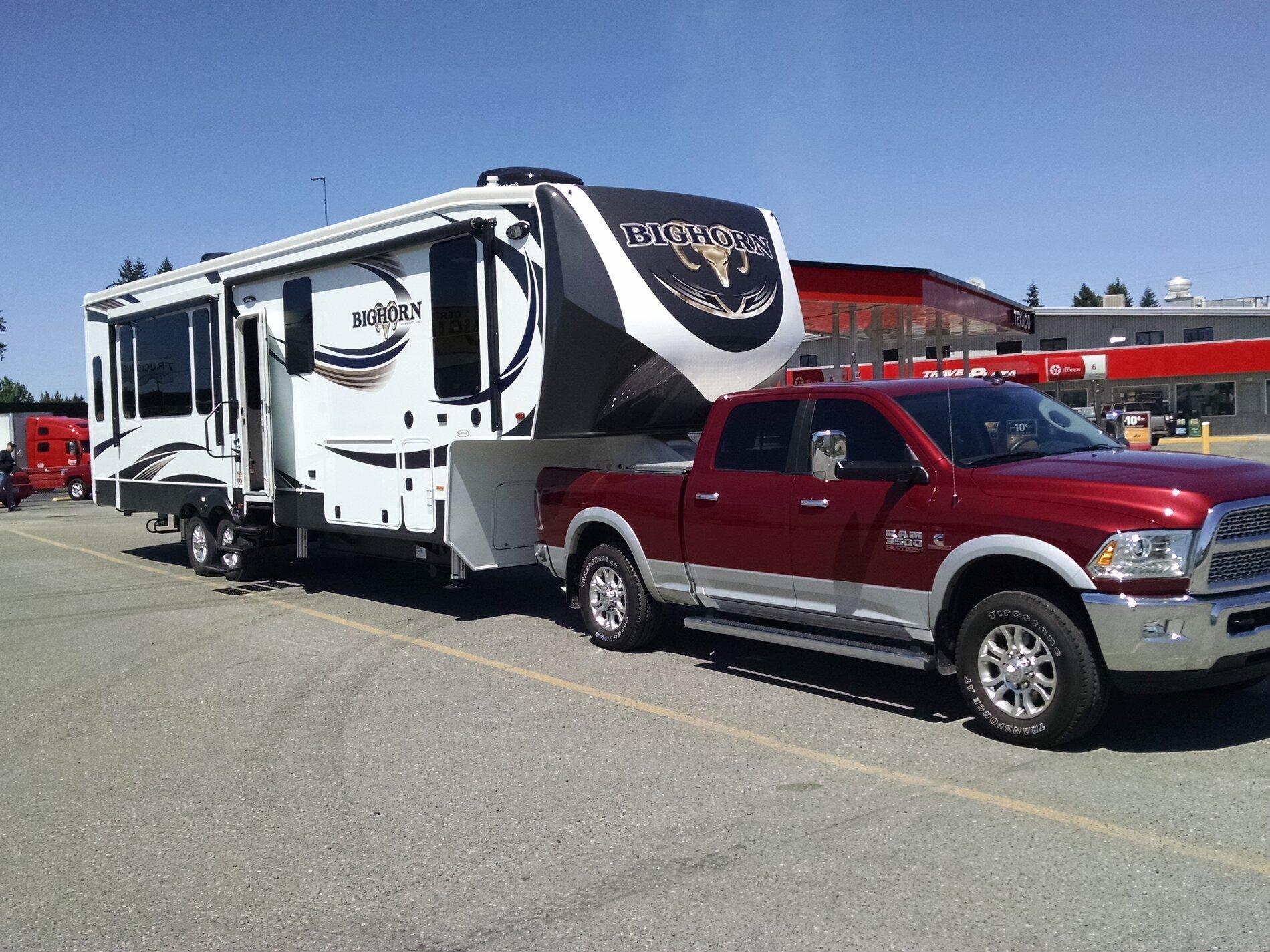

2015 was RAM more or less got their act together. Power folding mirrors on higher trim levels. 2016 gave ability to move cameras around. We towed a 16K 5th wheel with our 2015 4X4 CC SB SRW Aisin and it did well. Love my 3.42 gears with the Aisin.
2015 was RAM more or less got their act together. Power folding mirrors on higher trim levels. 2016 gave ability to move cameras around. We towed a 16K 5th wheel with our 2015 4X4 CC SB SRW Aisin and it did well. Love my 3.42 gears with the Aisin. View attachment 123191
Nice! My 5ver is 12,000# at full GVW. I’m supposing your truck has the exhaust brake as well? That is something I do not currently have. I wondered about the 3.42 gears and appreciate that someone has offered their personal experience. The Aisin is something I’m aiming for. I asked a question 12 hours ago and already I’m looking at 2-4 years newer than planned. Get good info and this is what happens! It’s all good. Good stuff SnoKing!
