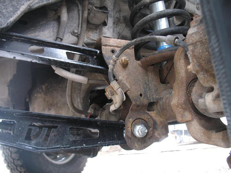

Hose the bolts down with some kind of penetrating oil to ease dis-assembly. Mine looked good and I still broke two of them. You can only get them from Dodge, too. The control arms will have to be taken completely off and the old bushings pressed out with a bearing press or melted out with a cutting torch. If you can beat them out with a hammer I will call you sir from now on. What kind of replacements did you buy? When I decided to do the job I said the hell with it and just bought after market control arms with polyurethane bushings from DT Profab. The extra money was well worth the PIA of putting new bushings into old arms. Plus the arms from DT are greaseable. Impact wrench is a must. Luck... .
