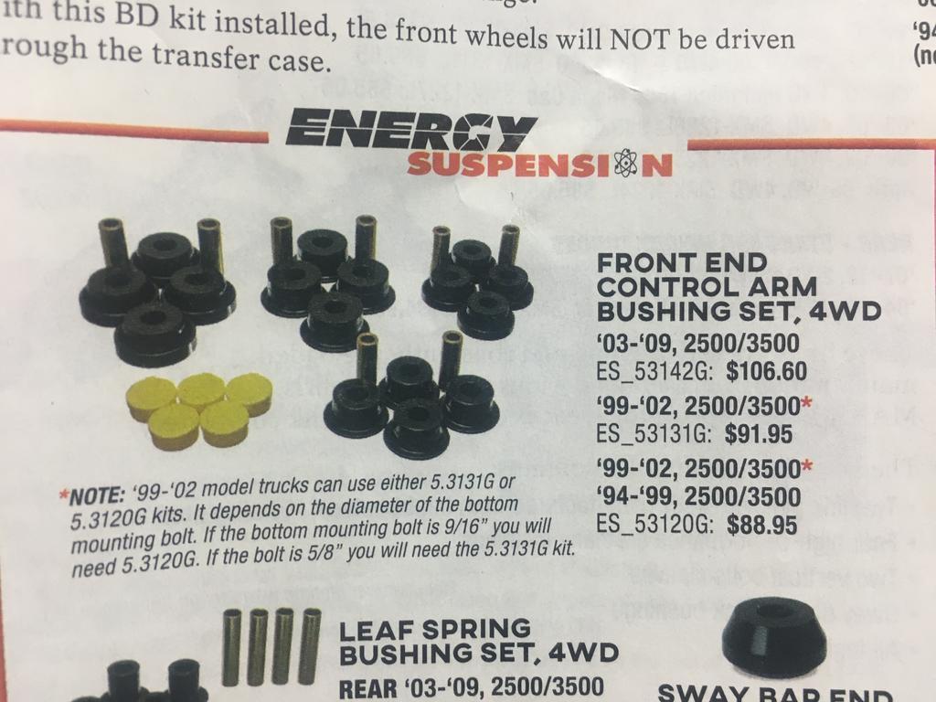

Has anybody used the energy suspension control arm bushing kits ?
I read somewhere that it is very difficult to get the old bushings out. They need to be torched out. I would imagine they work fine, but they will ride rougher than stock. I'm ok with that. My DOR control arms have urethane bushings at the frame and Johnny Joints at the axle. If you have any front lift, I would get aftermarket control arms that are 1/2-5/8" longer.

I had them in the my last set of aftermarket control arms and they wore out fairly quickly with noticeable movement (and an associated clunk) in the arm. They also like to squeak if you don't keep them lubed. I'm running Carli arms now with their greasable "johnny joints" and have no complaints, no slop, no squeaks. If that's more than you want to spend I'd just look for some factory replacements with rubber bushings.

I doubt many would feel any difference because of the bushing material.I have solid flex joints at all ends of my Carli control arms never felt any added vibration.
