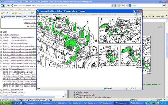

Wish I had a bigger picture for you....
Thanks. I found that drawing too. I looked around my engine block hoping to find another pipe plug in the block, but I couldn't see anything. I'm thinking that running it through the heater coil circuit which passes through the water pump will work out just fine.
