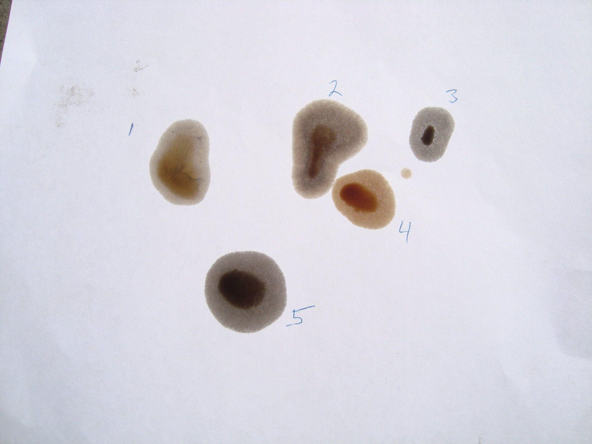

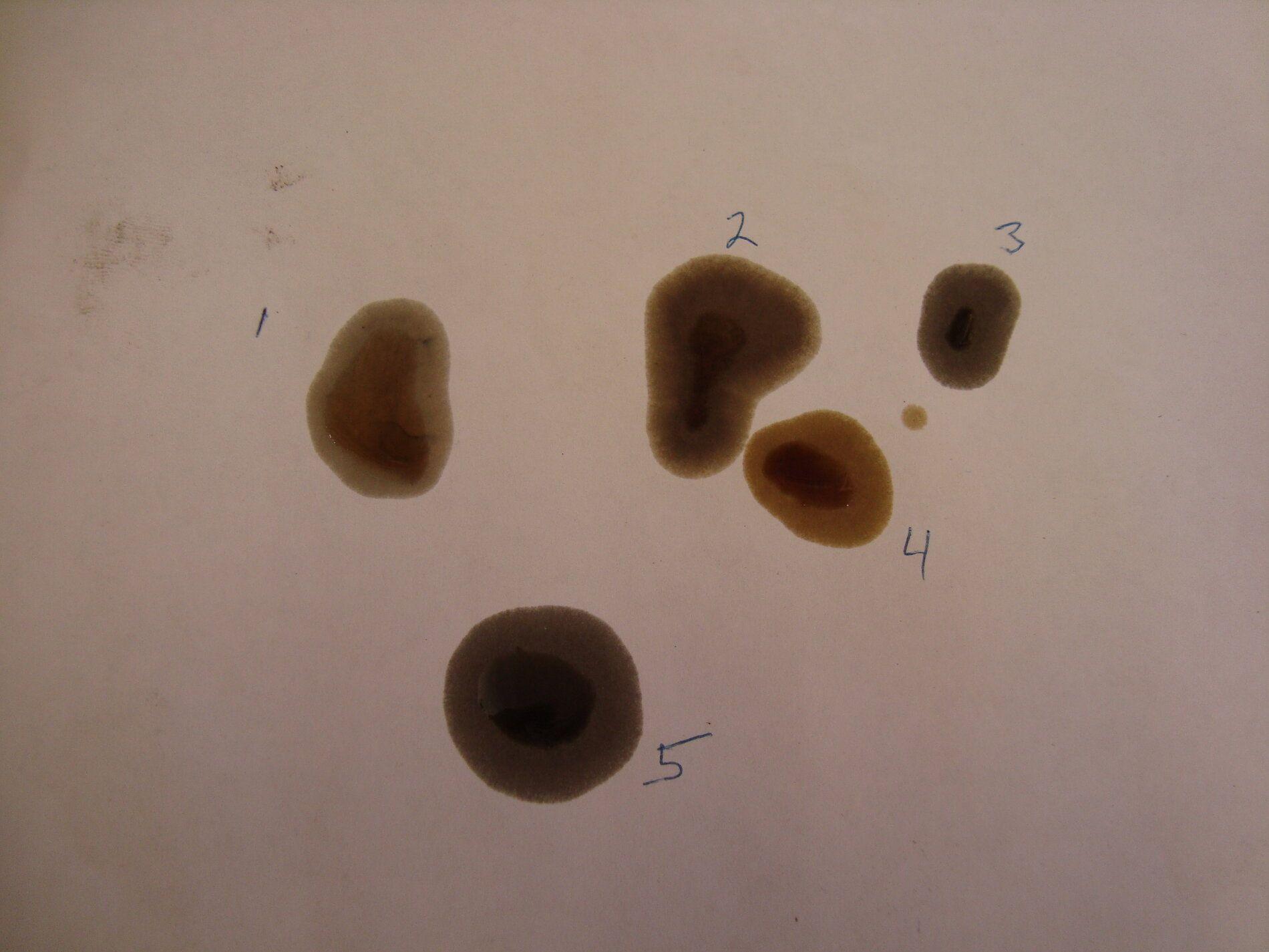

It is evaluated after the oil drop has been absorbed by the paper for some time
clearly visible circles of different colors have formed:
- The innermost circle is usually the darkest. It shows if soot / contain contamination in the oil
are. And the darker it is, the faster you should look for the cause.
- The next outer circle is hopefully brighter, because it shows the state of the oil as
Lubricant on. The darker, the worse.
- The next outer circle shows if water is in the oil. When water is in it, distinct ones form
Spikes on the edge. Water can be condensed water with a lot of short distance or cooling water
be. The latter should make us fast, because there is the cylinder head gasket
over.
- The last outer circle shows whether fuel is in the oil. The more, the wider the ring. Here
the mixture formation should urgently be examined.
Amazing is how clear the results
to "read". Also an untrained eye
See immediately if something is wrong. Consequently
this test is also for us
Hobby screwdriver usable. One should
knowing that the result all the more
the sooner it is clearer, the warmer it is
is testing liquid and if the result
does not immediately show clear results,
Just help wait, because the longer that
Test paper has time, the test
to perform, the easier it is
Read result.
